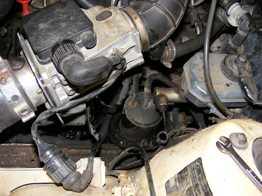

    So I decided to tackle a power steering leak...

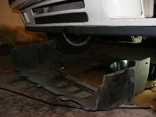

    So I dropped the engine shielding:

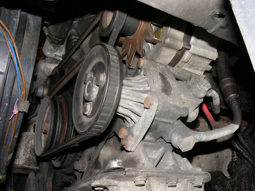

    and there is my PS pump, and yes, that zip tie is pink:
    Started unbolting shit, and out came the pump:

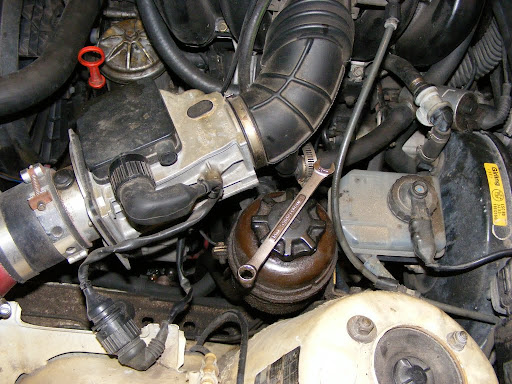

    So that meant that the reservoir had to come out:

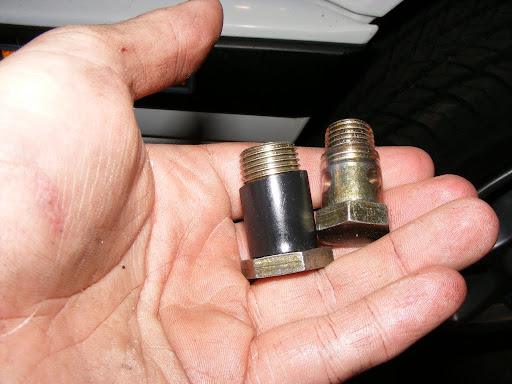

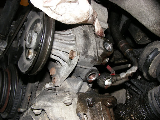

    pulled out all the PS lines, including the ones from the rack, and rigged up something high tech to plug the rack:

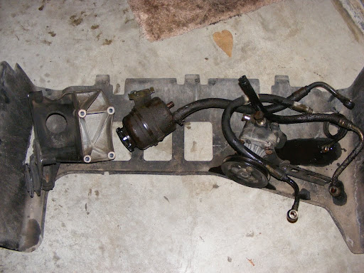

    And there is about 30 lbs of crap I pulled out. (AC bracket on the left there that got left on the engine after the AC delete):
    No more power steering leak!! No more power steering!!
    next up: my coolant leak. (just kidding!!)
    now my car is even lighter, and I gained like 1.5 precious horsepower!
    And btw, i drained the rack by turning lock to lock to pump the fluid out, and it is WAY easier to steer with an empty rack where I am not pushing fluid around.

                          Hmmmm, I kinda feel like doing this now. So is there no fluid in the actual PS rack now? I could actually look how the PS rack system works but meh...
                          - E30, DSM, Golf R, Mazda 3 Skyactiv
                          • Bimmerman325i
                            • 6854
                            I'd be careful taking all the fluid out of the rack, as it also is used to lubricate the mechanisms. Just a thought.
                            2017 Chevrolet SS, 6MT
                            95 M3/2/5 (S54 and Mk60 DSC, CARB legal, Build Thread)
                            98 M3/4/5 (stock)
                            • blefevre
                              • Dec 2008
                              • 4287
                              Yeah, I guess what I would do is put the lines from the reservoir directly to the rack. Mine is leaky, that way I can keep filling it up. Anyone know if those lines will bolt right up or do I need to make some adapters? I can't tell from those pictures.
