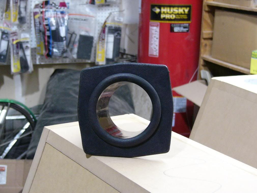

    OK, very first thing: find your port tubes (packed in dirty underwear or plastic crap, inside the box):
    Grab that sharpie and a screwdriver. Remove the stock midrange from the premium housing. Insert your port tube in the hole and mark with a sharpie where you think you need to cut to let it fall through, like so:
