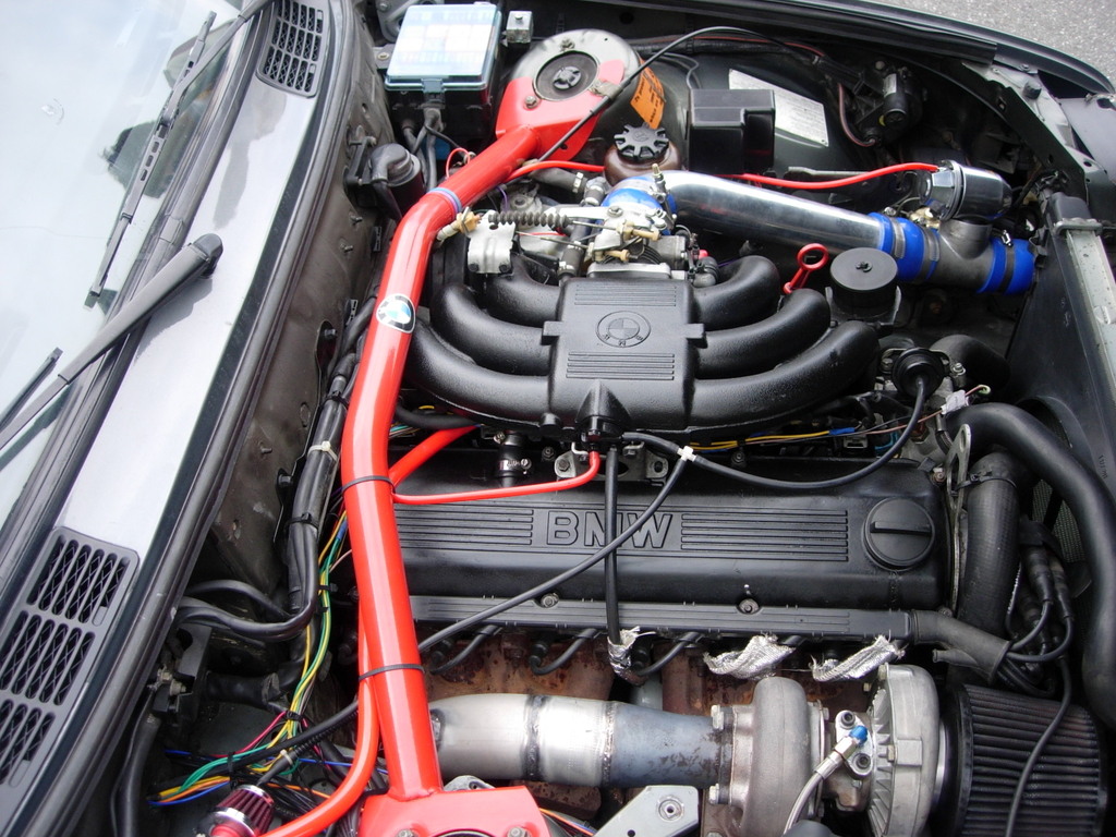

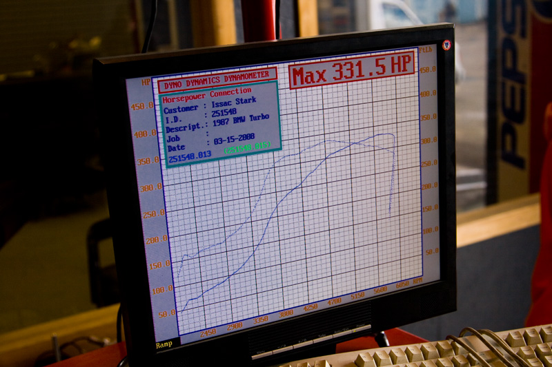

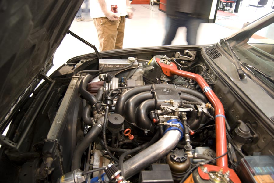

    Engine modifications: The motor is still an M20, but stroked and bored to 2.8 literes with JE forged pistons, eagle rods, MLS headgasket, 273 cam and lots of ARP hardware. Also is has been turbocharged using a 666 fab manifold adapter and a Holset HX35 Turbo from a 5.9 Liter Cummins Diesel. It is all managed by Megasquirt 1 firing GM waste fire coils and 60 lb/hr siemens injectors. It made just over 330 whp right after break in on 10 psi.
    Exhaust: 3in turbo back with a Borla XR-1 Muffler

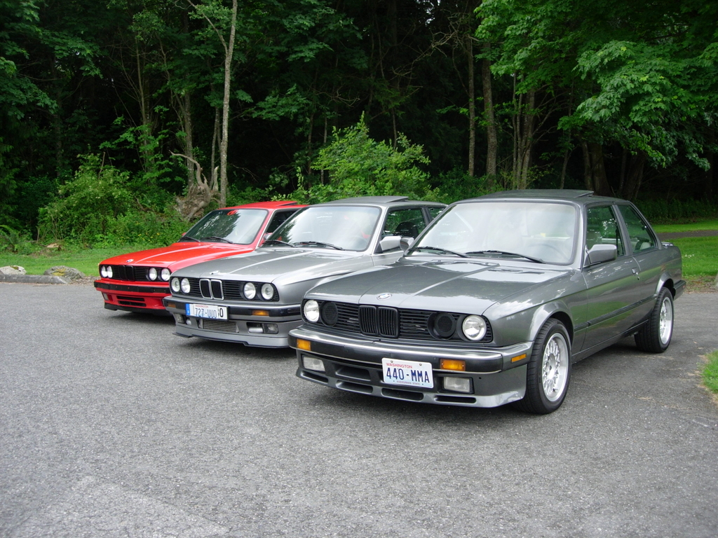

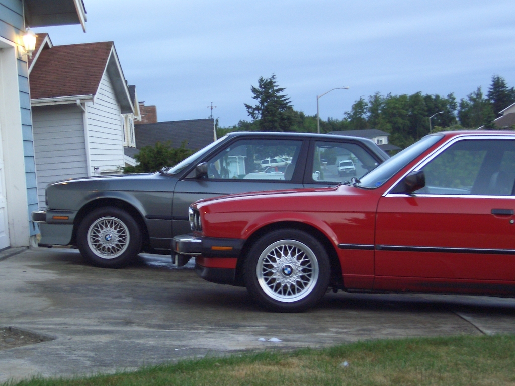

    My car as I bought it from the Craigslist Ad

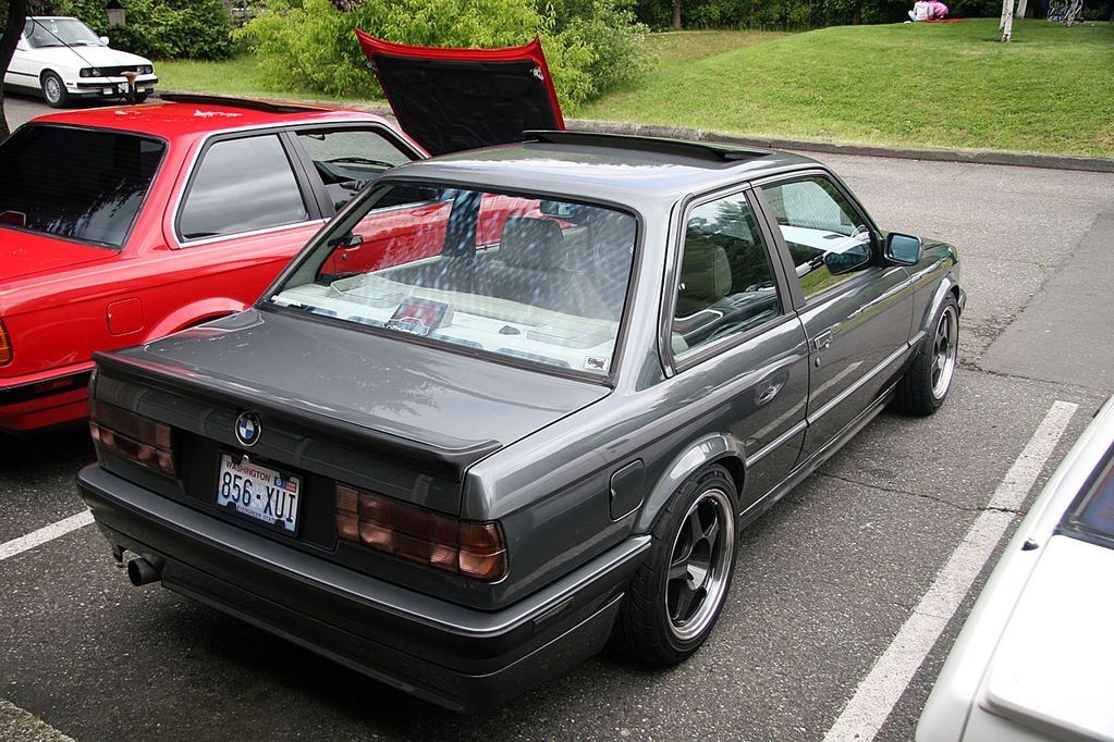

    E30 Picnic '06 w/ 4ce30 and Matt325is

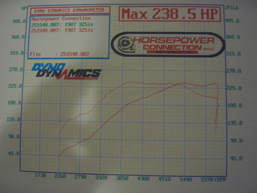

    E30 Picnic '06 and my vers. 1.5 Turbo Setup
    Dyno Graph From vers. 1.5 (@ 10 psi)

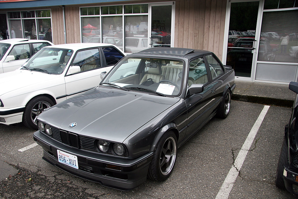

    Right when I bought my Zinno ETA
    Up at Mt Baker in 2007

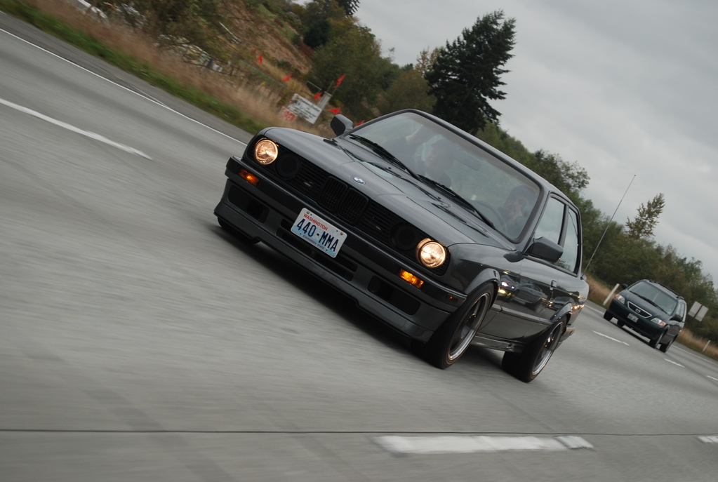

    Taken by Crunk3 on I-5

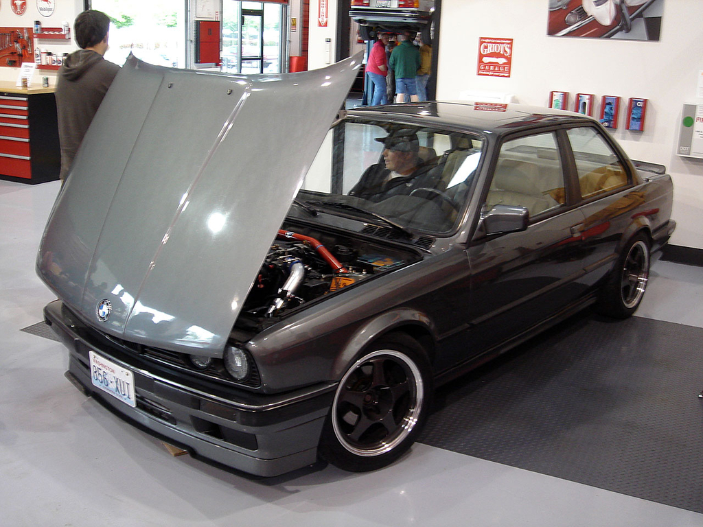

    E30 Picnic Tech Day '08 w/ Holmes in the Pass Seat
    Engine in vers 2.0 @ E30 Picnic Tech Day '08
    Dyno Graph from vers 2.0 (@ 10 psi)
