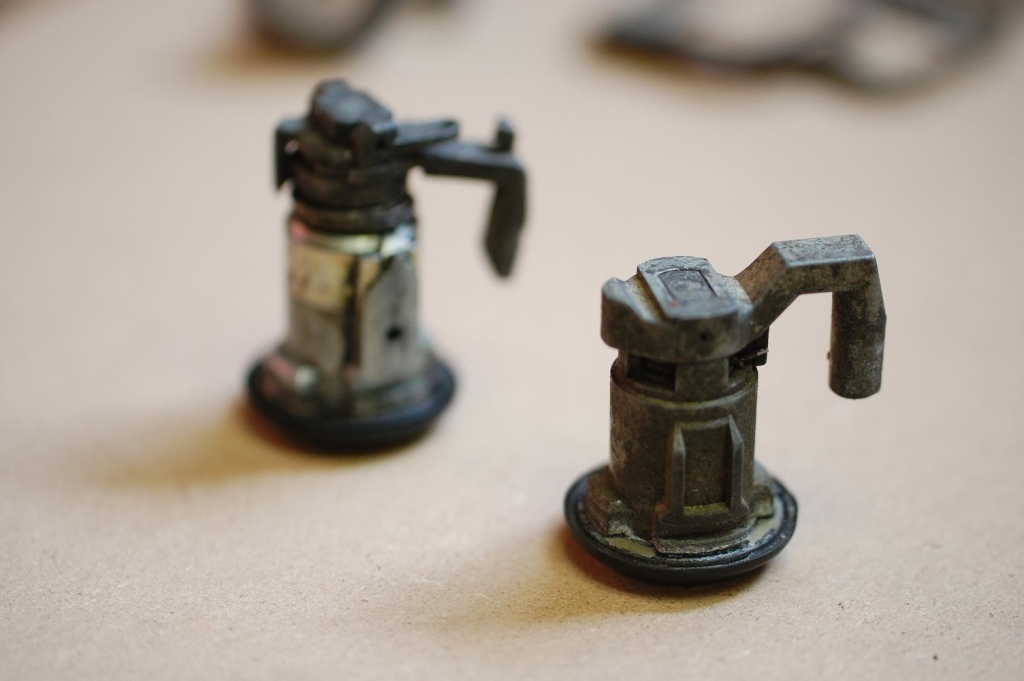

    14. On the left is a double lock assembly, on the right a passenger side key.
    You may note that there are more pins (12) in the double lock tumbler than the passenger lock (8 ). This is not a problem. Only the first 8 pins are needed to retro the replacement lock.

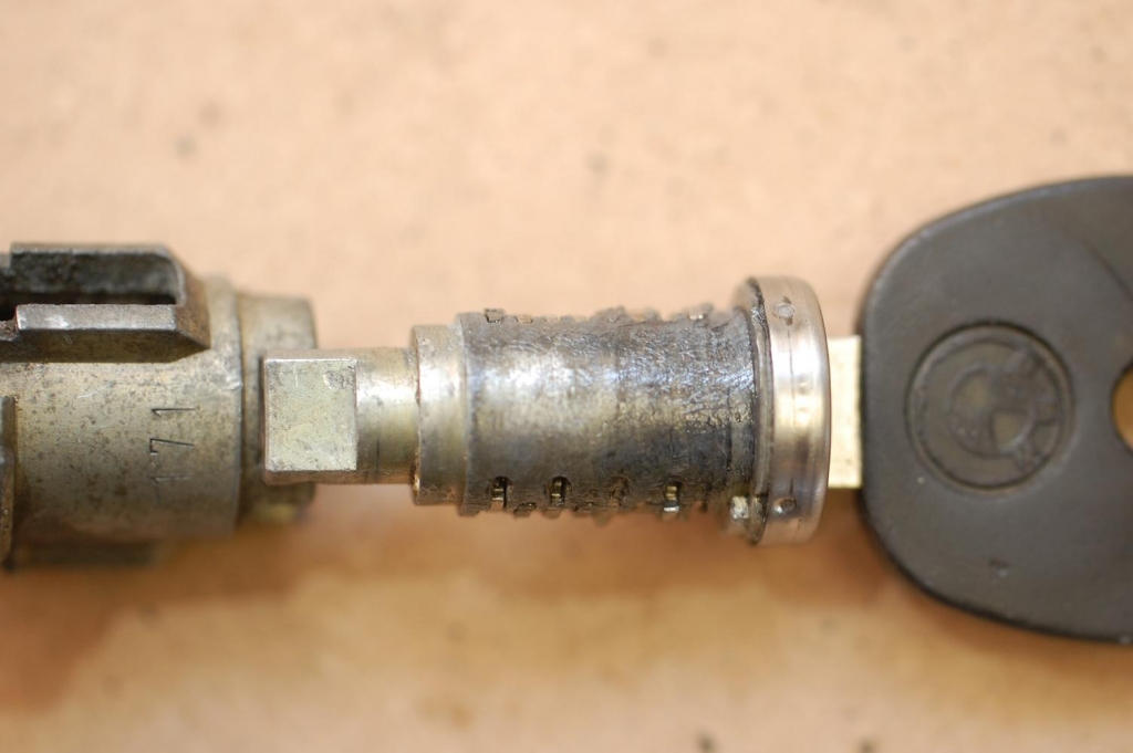

              Alright, so I pulled my driver side lock cylinder to diagnose why my driver side door couldn't be locked from the driver side. It has already been rebuilt with the OEM rebuild kit from the dealer. I see that this post notes that the key must fit in with the pins being flush to the cylinder on both sides. I pulled my lock cylinder out too quickly and the pins fell out....I managed to find the pins but I am lost! And to make matters even worse, there are different shaped pins! I have included a picture of the two different pins I'm talking about, please help me guys!

                What kind of help are you hoping for?
                This is a good tutorial. It clearly states that there are, in fact, four types of pins. Not only two as you state. They are marked with numbers as you can see in the pictures.
                Your pins did not fall out because the lock cylinder was pulled out too quickly. The pins are held in place by the key. Only when the key is removed are the pins able to release.
                Whatever. It will be necessary for you to experiment with the pins until you find the one combination of pin placement that allows the pins to fit in with the pins being flush to the cylinder on both sides. Just like you said in your post. Easy peasy.
                Kind of like a jig saw puzzle with only, what ... eleven pieces.

                  Dogsbark, clearly there are differences with the pins I posted in the picture. One is slightly more narrow near the bottom. I'm just trying to make sure I'm on the right path.

                    Guys, I FIXED IT! :D
                          Correct.
                          There are two different types of driver's door lock cylinders -- those with (the longer one on the left), and those without (shorter on the right) the "double-lock" feature.
                          The longer "double-lock" cylinder has 11 tumblers, versus the shorter non-double-lock cylinder which has only 8.
                          The first 3 (or 4?) of the 11 tumblers in the longer double-lock cylinder have the narrower notched ends (see image with first two tumblers removed) compared to the remaining tumblers which all seem to have rounded smooth ends.
                          So, yes. "JOATiUBER" has a valid point. There do appear to be two different types of tumblers, with notched ends or smooth ends. Each can have different shapes but they should all have an identifying number stamped into them.
                          If you get them mixed them up, you'll have to use trial and error to get them back in the correct order. The objective is to get them all to retract flush when the key is fully inserted.
