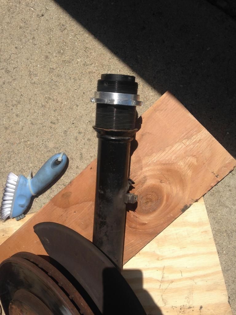

    Driving it back home (which was only like a 10 min drive) was the scariest and most violent ride i've ever driven. Turns out, not only were the shocks blown, but the previous owner did some kind of homemade Dr. Frankenstein hack job drop using the d2 parts. It wasn't even adjustable anymore. The "coilovers" were rendered useless.
    As you can see, he cut the strut housing, put some kind of thread around it, and just used the locking ring, which was dialed all the way down against the cut strut housing, as the spring seat ring. The threading doesn't even fit flush around the strut housing. It's about half an inch wider. The ACTUAL spring seat ring (which happened to be in the trunk) doesn't even fit on the threading!
    After considering my options (which included just getting the spring seat ring machined to fit onto that thread and keep rocking with that setup), I decided to completely re-do the suspension.

          I wanted to get coilovers, but I thought about back when I had coils on my GTI, I NEVER adjusted the height anyways, so what's the point? lol Decided to try Bilstein Sports with lowering springs.
