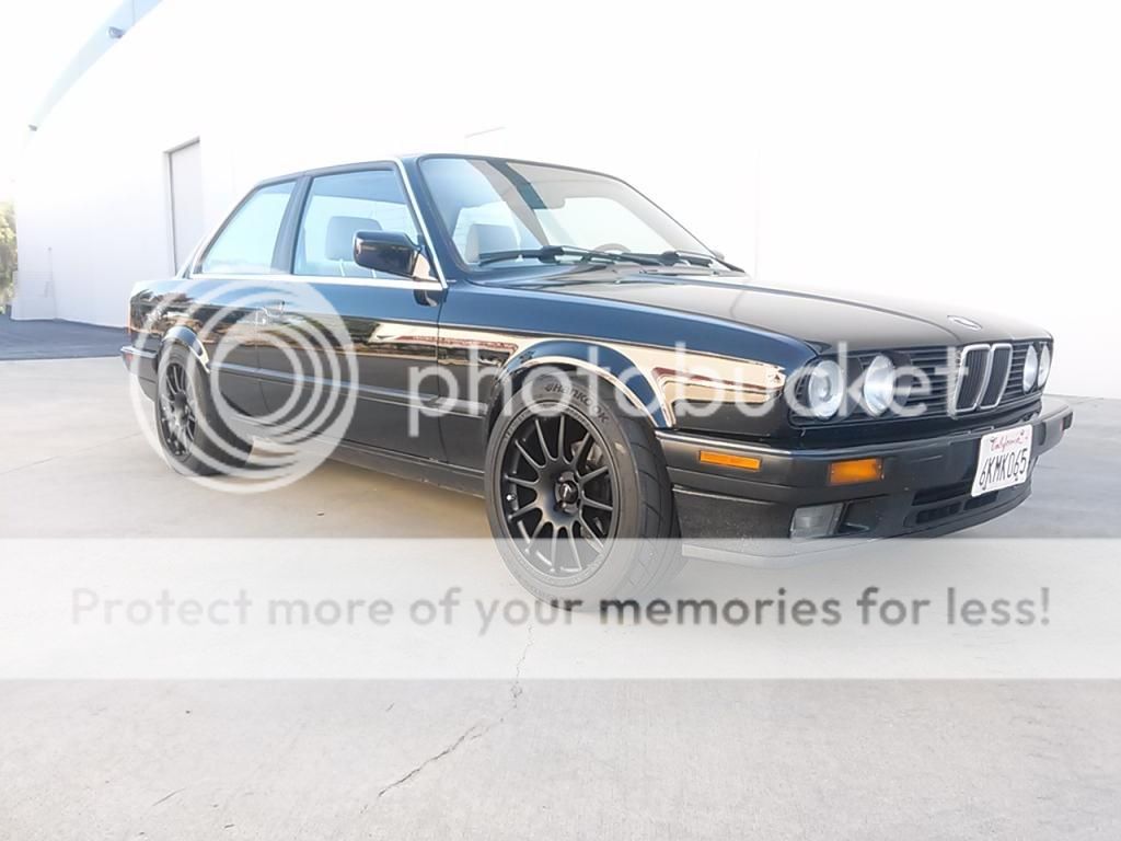

For sale is my 1990 325i 5 speed with 208k on the chassis and 20k on the engine. The engine is a 3.1 liter M20 stroker i built to resemble Metric Mechanic's 3.2L sport engine, but with a schrick 284/272 cam. I have a clean CA title and smog certificate in hand as well as detailed maintenance records, build spec sheet on the engine, and stacks of receipts.
I bought this car while living in the Chicago area. I spent a long time searching for a rust free car with a straight body and when this one came along in September of 2007 i snatched it up. It was a two owner car at that point. I registered it in WI since i never changed my address until we moved to CA in the fall of 2009. It's always been garaged and stored winters (in the midwest) under my ownership.

Wheels and Tires
17x9 Team Dynamics Pro Race 1.2 wheels with et27 offset and 12mm spacer up front for strut clearance
245/40/17 Hankook RS3 Version II tires
57mm Turner wheels studs. Fronts are shortened slightly to clear the center caps of previous wheels.

All in the car is in great shape mechanically and ready to go another 100k. Cosmetically though it does show signs of it's age. A couple items to note, which are all visible in the pictures are: The paint on the hood to the left of the roundel is starting to crack. The dash has a vertical crack on the passenger side above the glove box. The sport seats show a bit of wear and are in need of new struts.
