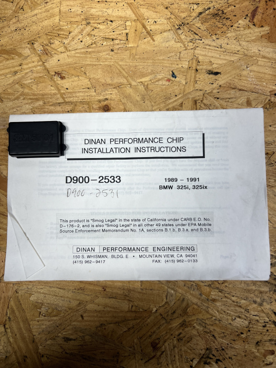

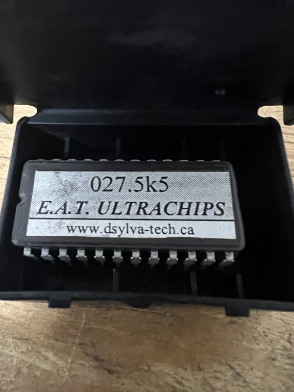

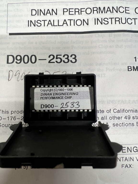

    1989-1991 Dinan Performance Chip
    Dinan Perfomance Chip for 89-91 325i. Came with my car, I just never installed it. $100
