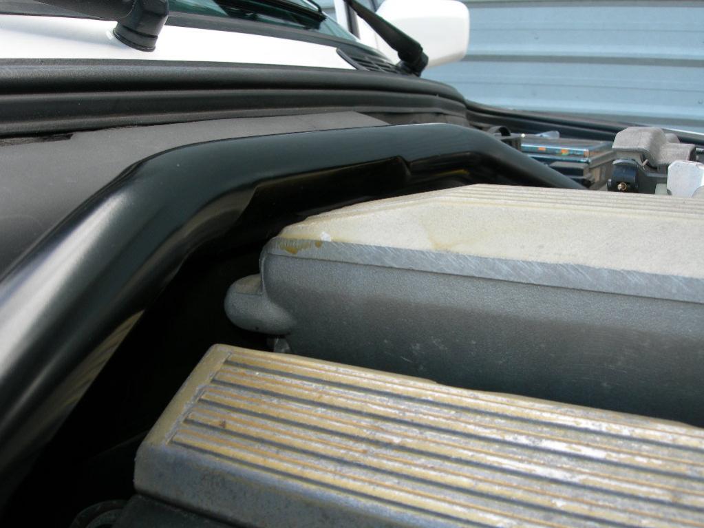

    I was thinking about that. The only thing is that I really don't think that this would ever see stresses that making the bar like that would be needed. If you look at most of the other bars, they weld the end plate in the middle of the tube, I don't think that they are cutting slots into the tubes. That not really the easiest thing, but if I'll ask my fab shop if they can do it for not much added cost. This design is still plenty strong, but isn't too complicated.

      i was also thinking all of the stress is on the welds, if the design is updated to asses that, i might be game.

        Look at other strut bars... some even have less welding on them then mine and all the stress is on the welds. In all honesty, the bar should never see stresses great enough to break the welds. That would take alot of force, probably far far greater then anything your car would ever see.
        If it will get more interest, I will look into this.

            I fully agree the current setup is enough to handle normal stresses the car would see. Never hurts to make things more robust though.

              I hear ya, I think I might be able to figure something out. I make all the tubes, I'll test it out on monday. The other reason I didn't do that way was to stay away from all the designs you see out there. From what I can tell, existing bars don't include a slot in the end of the tube now and I don't like the small amount of well you can get with that style. I'd be more worried about cracking one of like that cause you've got barely any weld.

                    This is kinda what i was thinking... you can see the bar on the left, and on the right is the tab, blue is the welds, and red is the bar. For additional strength you(or the buyer) could even drill a hole in the top of the bar and put a bolt/nut through it so it would be impossible for the tab to separate from the bar. Excuse the MS paint skills

                      I redesigned it similar o that, but I couldn't do the slot in the bar. I made the plate tab on to the tube like other, but I have a total of 8" of full weld holding the plate on to the tube. I worked on this with a fellow member who works as a structural engineer and we work it out this design would be nearly 10x stronger than what I had originally. It would take a huge amount of force to break these welds. I you look at others, they've only got a tiny little welds mounting these plate so I am not worried about it.

                          Yeah im liking this much better! The torque pressure will now put stress on the bar instead of the welds. Would still be super sexy if you could slot the bar =]

                            I looked into it and it really isn't going to make it any stronger. Plus the added work will just make it more expensive.
