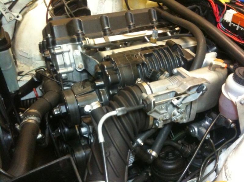

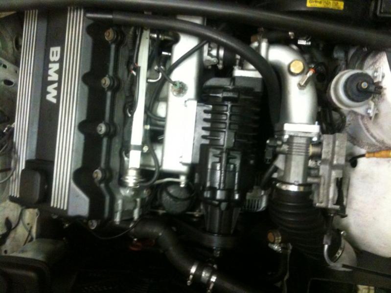

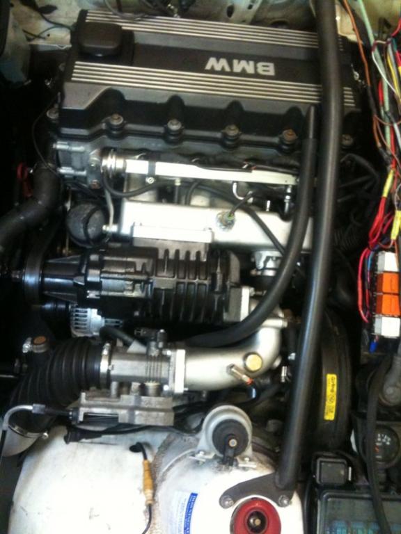

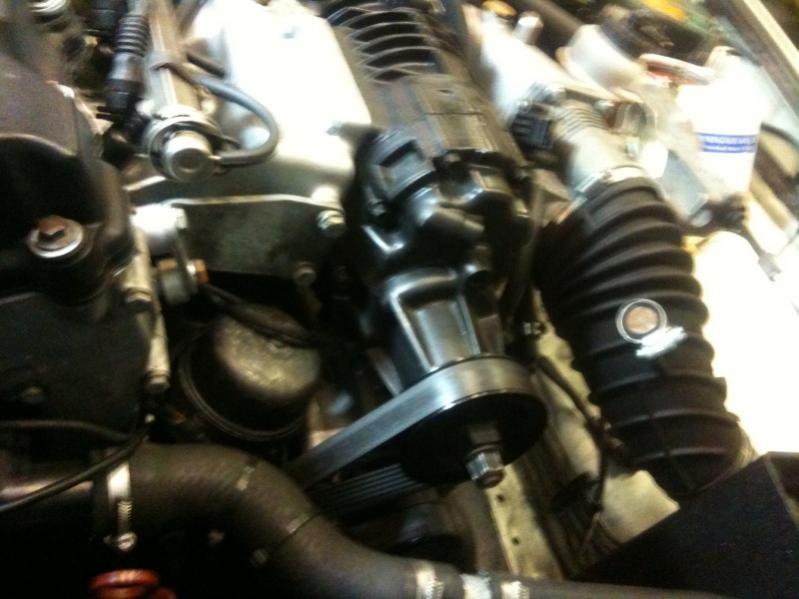

                          • JiXer
                            • 620
                            Pics.
                            Crappy ones. I can't seem to remember to take my good camera to work where I keep this car.

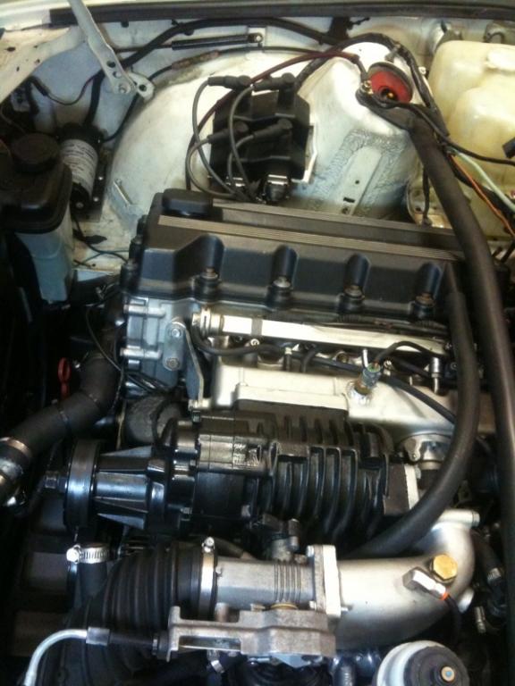

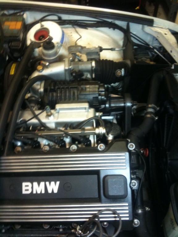

                            • JiXer
                              • 620
                              1 more
