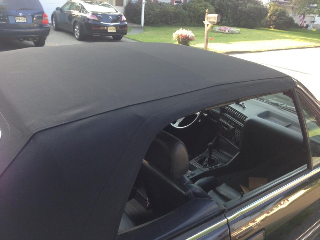

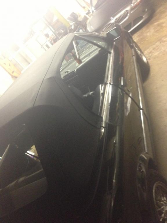

          late night updates
          another finished pic. i love the first stretch on a brand new top!
          don't mind the poor quality.. camera phone and it was like 11pm.. so it is a little washed out by my fluorescent lites

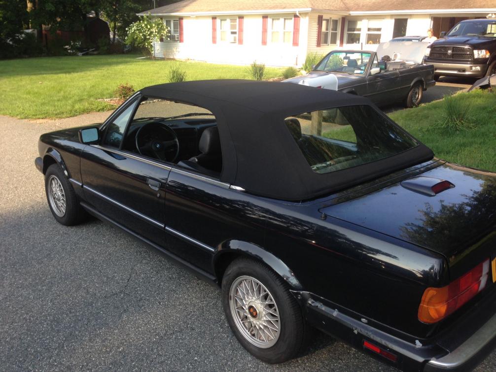

            final pics
            over-view
            • fuzzysux
              • 247
              #66
              pics
              close up

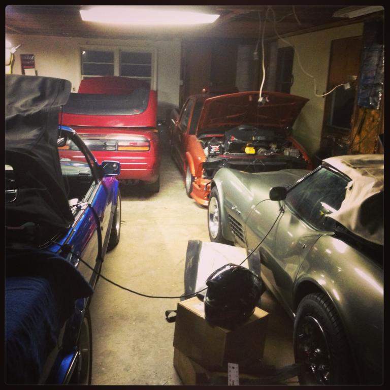

                            non e30 top progress pics
                            some of the non e30 tops from last month

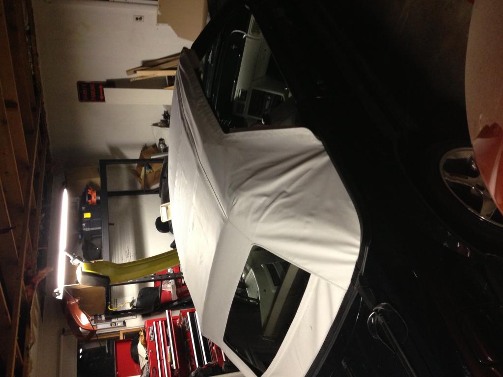

                              #74
                              fox body mustang
                              2 part top with glass window on a fox body - this is not the finished product - but a mid-fitment pic.

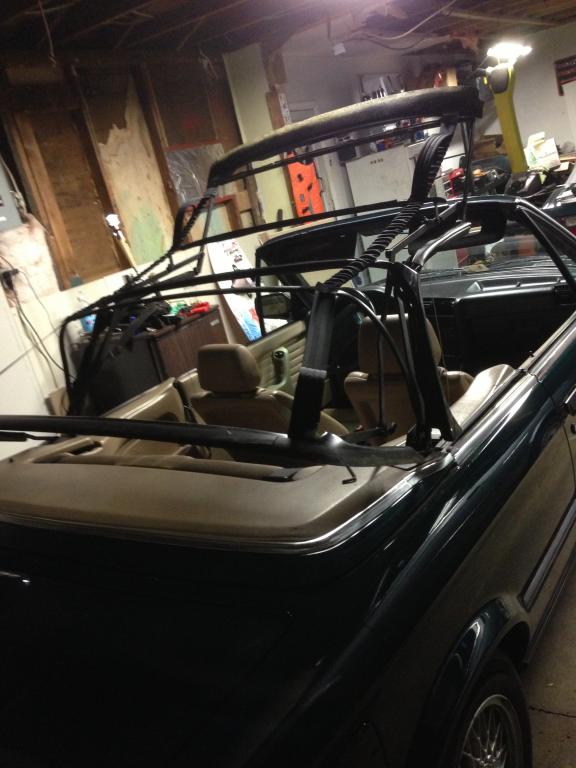

                                #75
                                this is what your top should do if the straps are good
                                so once you unlock the front bow, your top should snap up to this position. if it does not, your straps are shot. i've done a lot of straps with customer tops this last month. this is a customer car with new straps just installed
