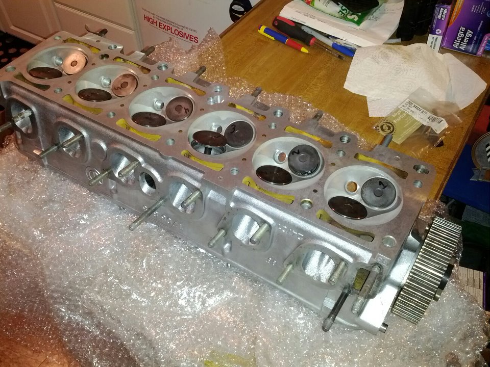

    You absolutely do NOT need an adjustable cam gear. We have never run one on any of the heads/engines/cars we've built. If you were to get a seriously large cam you "may" need it but anything in the 270-290 range will not require it.
    The cylinder heads are shipped complete with cam gears and oil tubes. You will of course need to swap over your intake manifold, thermostat housing, exhaust manifolds, and valve cover.
    The intake and exhaust studs absolutely do not need to be replaced, they are not a wear item. We check and replace any damaged studs before a head ships to a buyer.
    All you would NEED is the HG set and the timing belt set. If your water pump only has 10k on it you really should not need to replace it. If you don't have a Beltley repair manual I would recommend getting one to guide you through the head swap.

        thanks for the quick responses. I have the bentley and have read it a few times now.
        Was just going over the pictures and was wondering about the studs.....I'll prob be placing an order soon. I know I need the various replacement kits, and I'll prob end up replacing a shit ton of rubber on my coolant system.
