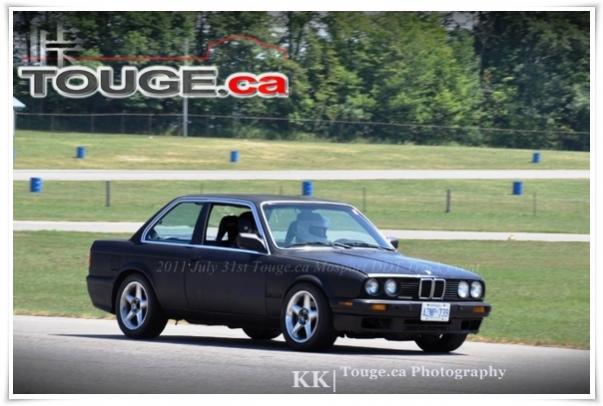

Selling a complete M52 swap. I completed the swap at the beginning of summer (2011) but I like having a project on the go so a completed car does me no good! :nice: Would like to part this car out and move on, got another E30 project ready to go :)
M52B28, 100% rebuilt using all OEM components. Main bearings, con rod bearings, piston rings, valves guides etc etc. Vanos is rebuilt with a complete Dr. Vanos kit. Broken in using the motoman method, first oil change at 30km, switched to Redline 10w-40 at ~1000km. Have approx 2000km on the rebuild.
Has been upgraded with S52 cams, M50 intake, cold air intake (modified to have filter in brake duct area, enclosed in a splash/rock shield)
The exhaust is eBay long tube headers into single 3" stainless pipe all the way back. Magnaflow cat, Borla muffler in middle and another magnaflow muffler out back. Only uses the front O2 Sensors.
OBD II computer with EWS delete, rear O2 delete. Tuned for M50 intake, S52 cams and the headers. The tuning was done by TRM.
My E30 is an early model, so the wiring adapter is the rectangular 10 pin. If your E30 is a late model you will need to make your own adapter. I can help you make yours if requested, it is easy and well documented here.
E36 328i ZF manual transmission and driveshaft. Shifter not included. If your car is an automatic, I can add all the components to convert your car to manual for extra cost
IX Booster, 25mm master cylinder and all the other little fiddly bits like the frame mounted FPR, hoses/lines etc etc. Everything single part in this swap is new or rebuilt.
I realize this is a long shot as 99.9% of the members here are in the US, but I might as well advertise where i can!
Price is $3000. Could do the install for you (negotiable) over a weekend too if someone wanted to make a trip out of it :D Will not part out as car will go back to being my summer drive if not sold by the time track season gets going.
A few of the car

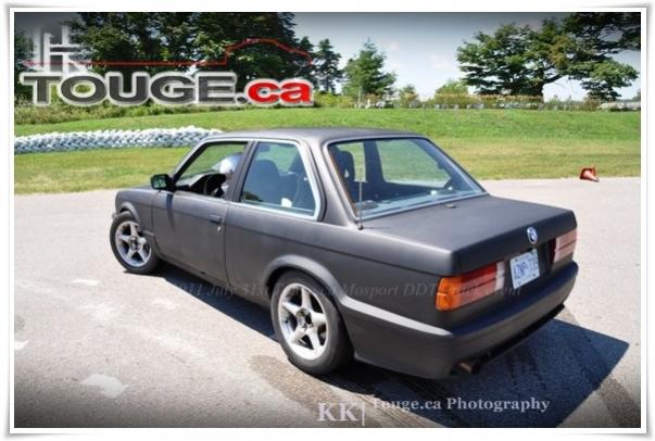

A few of the car
