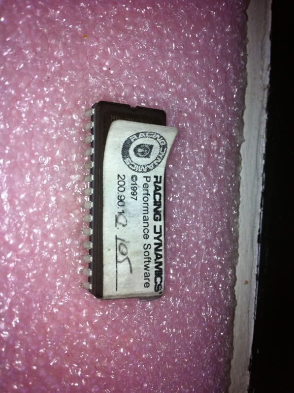

    I have a genuine Racing Dynamics K27 stroker chip. Back in the 90's the k27 was at the top of the big name bmw/M20 tuners horsepower race.
    The previous owner bought it from racing dynamics in 1999. This chip came out of my stroker as it no longer matches my engine specs.

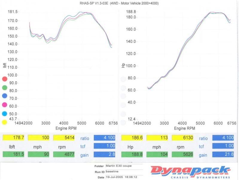

    It dynoed at 188.8 rwhp and 181.5rwtq without headers on a stock air box and catback exhaust. 200whp with a good intake, headers and full exhaust should be possible, maybe more with porting or a mister-e head. Redline is 6900rpm. It never pinged with premium as many chips and tunes will at these specs. This is very close to stock s50 territory.
