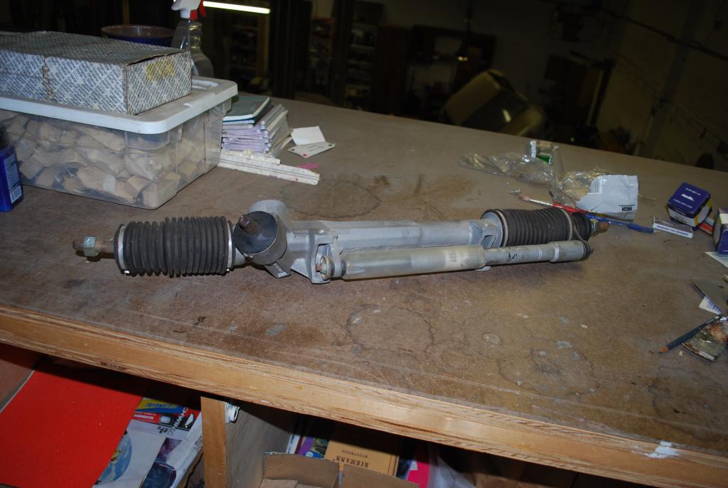

There are two types of euro manual racks, the "normal one" which is very slow ( I think it moves around 23 mm/turn), it has a variable ratio and has about 4,5 turns lock to lock. It was introduced late -85.
The other manual rack moves 34 mm/rev, and is not a variable ratio rack, it has 3,9 turns lock to lock and is much nicer to use. It was used until the other rack was introduced 1985.
