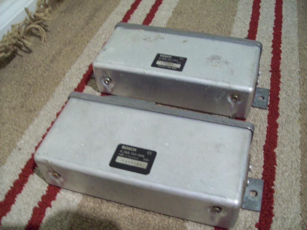

Both in excellent working condition. $18 plus shipping each.
ABS Modules 0 265 103 004

Is this the typical cause for a thrown ABS light from the SI board?Comment
Not trying to start crap
But the typical cause of the ABS light is the fusible link inside the ABS relay underneath the steering column. The link will burn to a crisp if the electronic system were to were to be introduced with an excessive amount of voltage (IE, a short, or attaching your jumper cables backwards). There is no fuse for the link, so when the electronics are overloaded, the link just pops
If you're having ABS troubles, I would check your relay before your moduleComment
