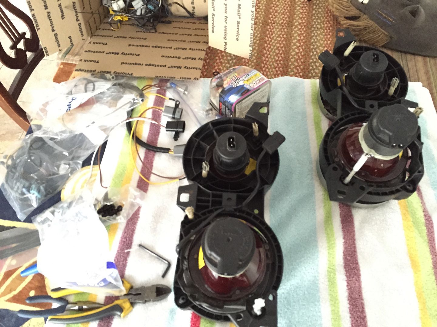

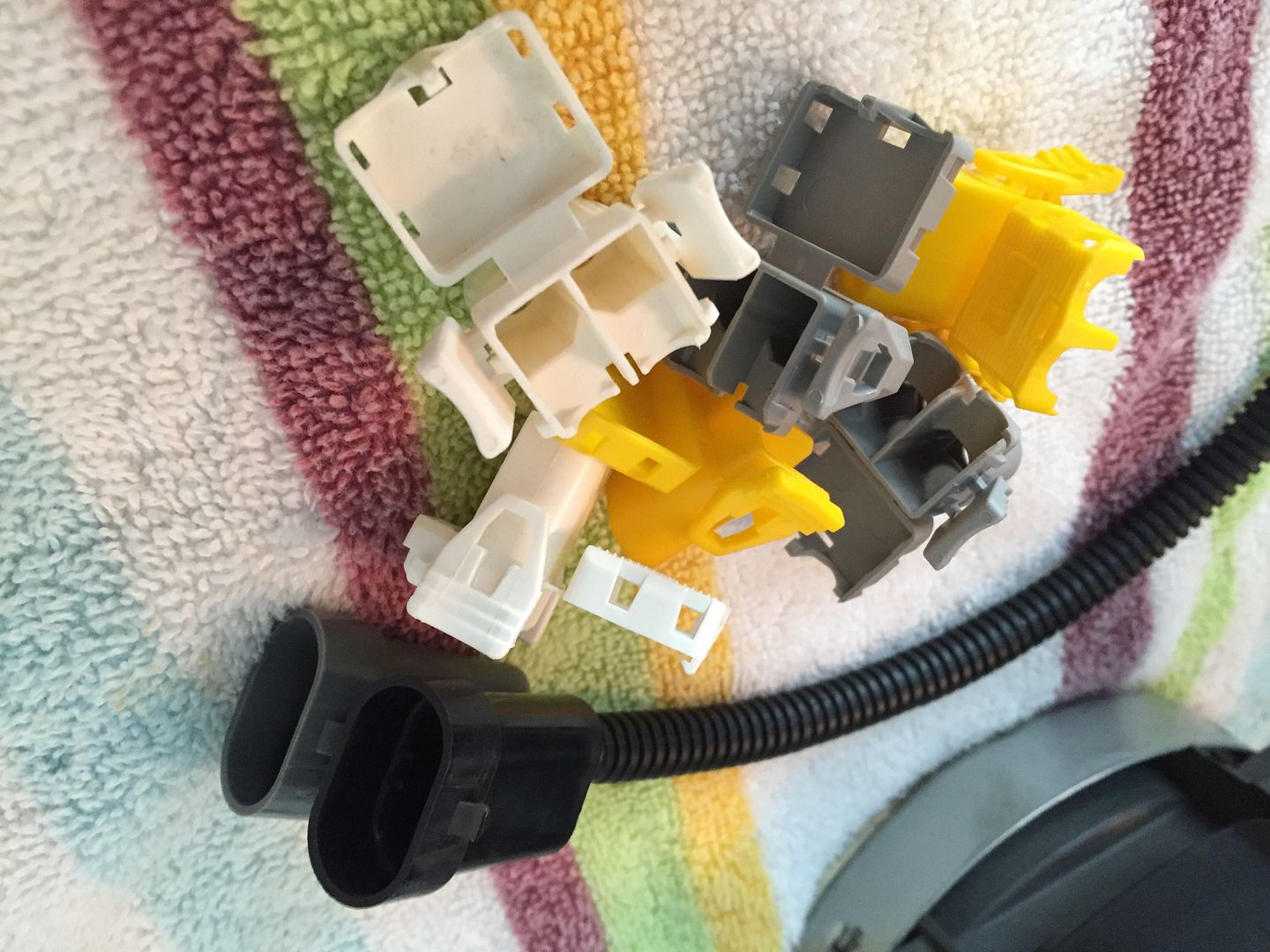

        This is the mess of stuff i'm starting with. I prefer Bosch so that's what i'm using but it's the same as hella. I also have an aftermarket set of crosshairs i'll be doing too.

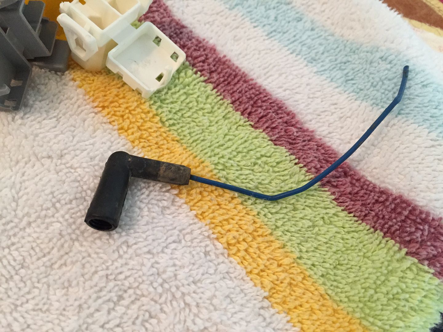

        These are the not cheap connectors. The nicer 9005/9006 adapters are specific and have the single or dual plastic tabs while the not cheap are universal and fit either.
        These things cost almost $5 each new
        This is how the stock connectors go. I'm gonna look to see if the connectors are available in different angles too.

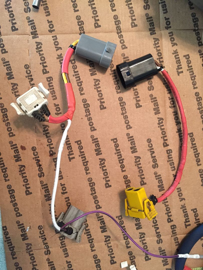

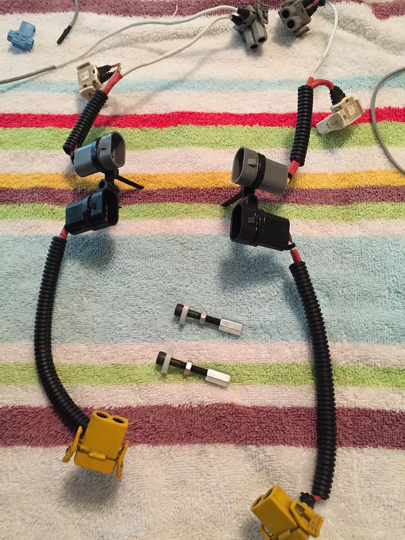

              I finished one side and the other side is ready to solder. This is the prototype to help me figure out lengths of wire and shrink wrap. The final product will vary slightly. I plan to use all black shrink wrap. I think i might just focus on making the brand new adapter, i wouldn't want to sell some with the used connectors and have a clip break or something. The used connectors sometimes don't have enough length and can limit the design. Once i have everything set up and have enough supplies in hand i will make a few sets to order and see how that goes. I will have a final price by monday for the brand new plug and play adapter, it will definitely be over $100 unless i can find another source for those little L connector wires.

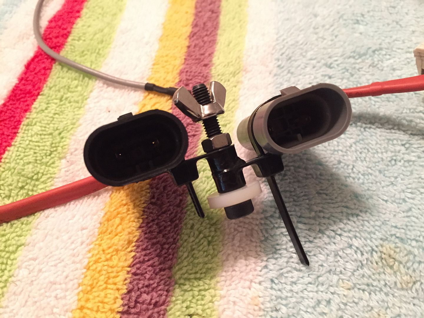

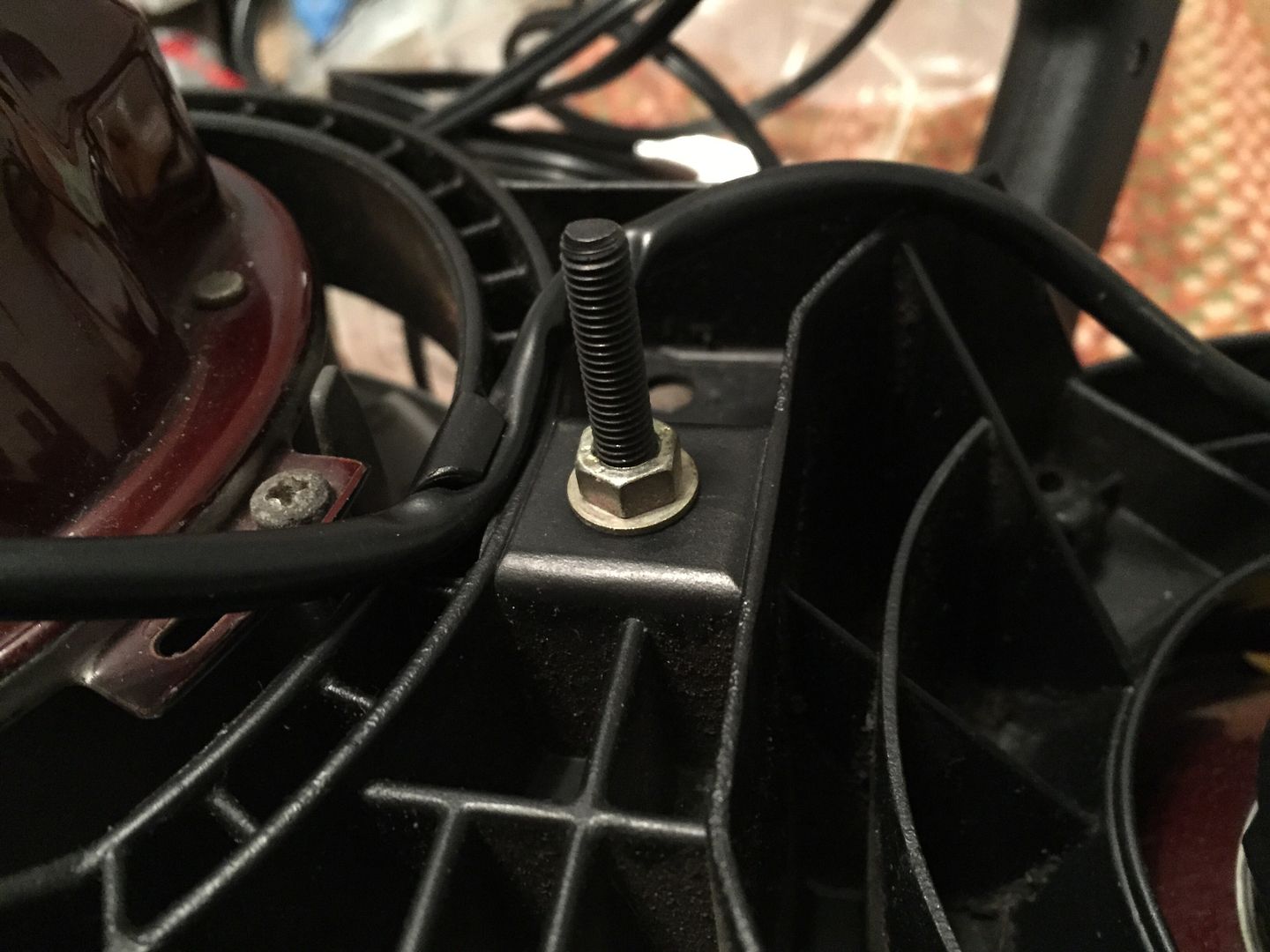

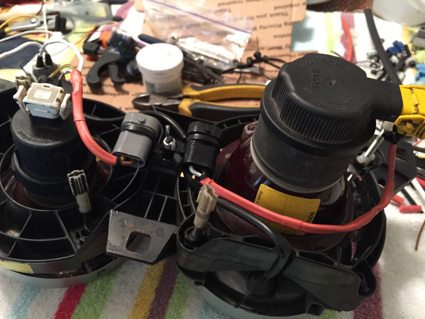

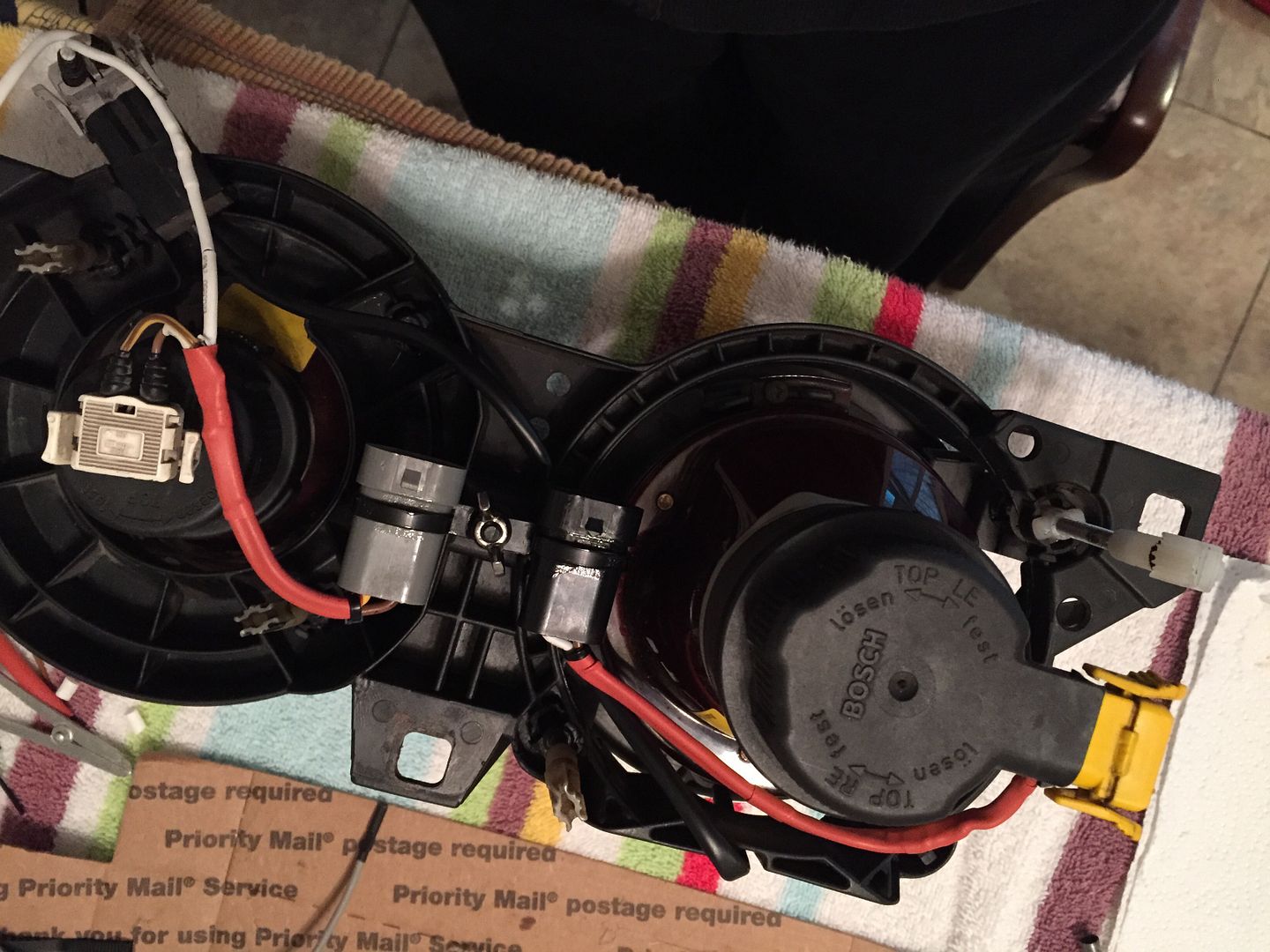

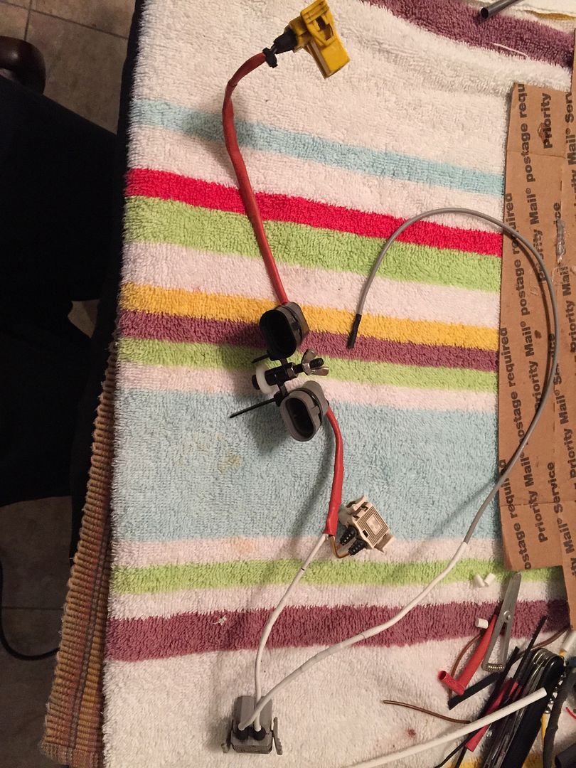

                  Finished the prototype. I will be improving on the design as time goes on, i'm still on the search for parts i can use. We have rain today so can't test them. For the ones i sell i plan to install and test every harness before shipping. Any hardware used is grade 8 or above and metric. I use a nylon spacer to center in the hole with a nut securing the mount to the frame. The harness mounts onto the bolt and is held in place with a wingnut for quick removal.
