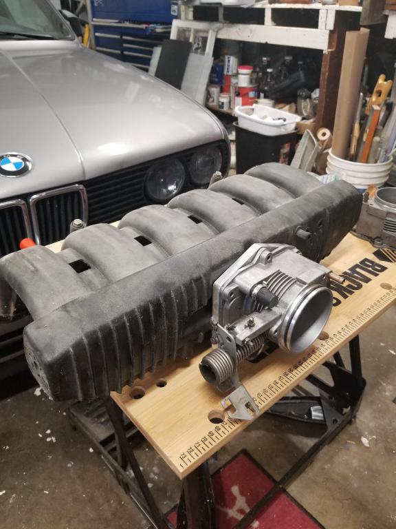

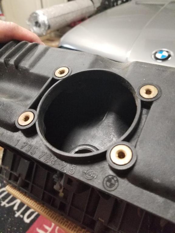

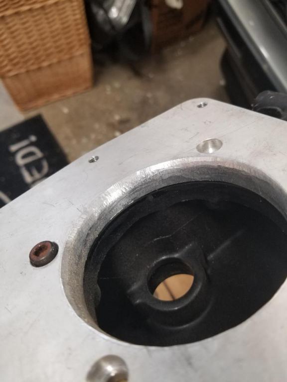

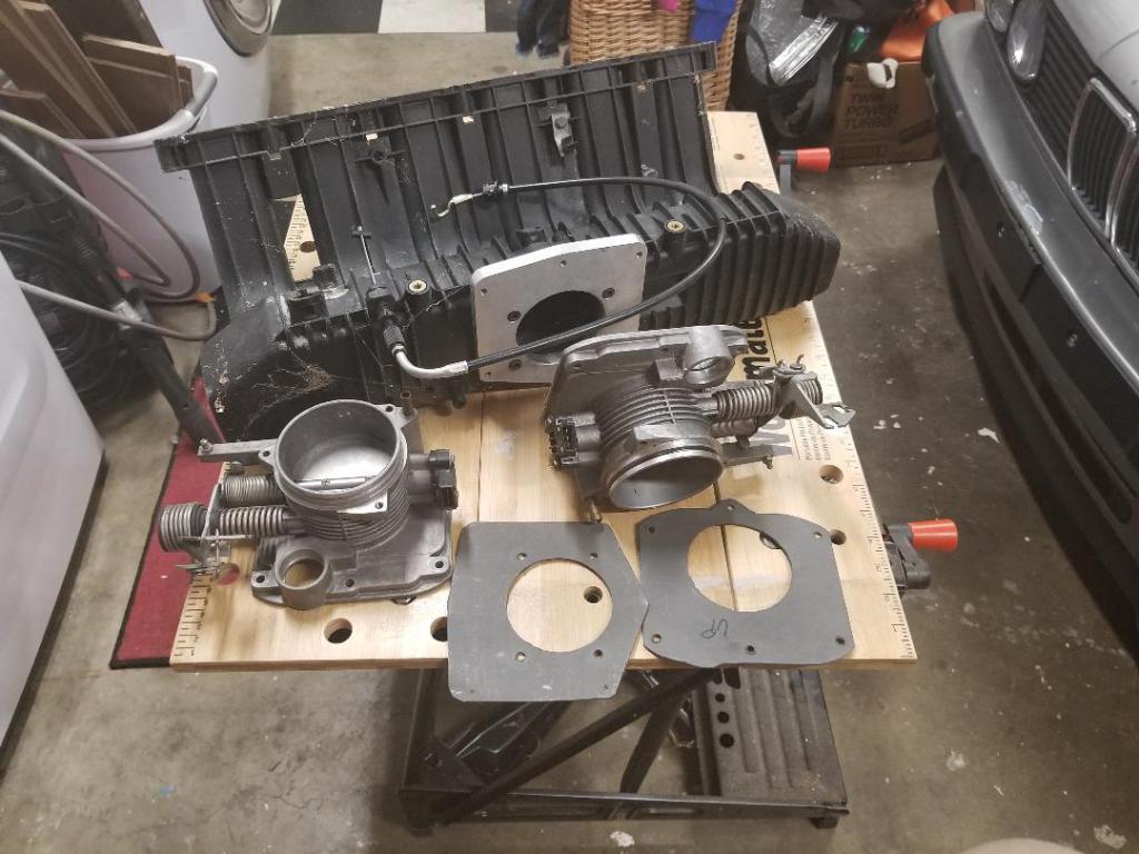

    FEELER: 3.5 inch Throttle Body with bored M50 Manifold
    Got a kit from treehouse racing a few years back. Took the adapter plate for the 3.5 inch 740i throttle body and bore matched it to the M50 manifold. Kit comes with M50 manifold and 3.5 inch Throttle body and cable for a E30. See pictures below. Looking to see how much this is worth in the e30 community.

          I have this setup installed on my S52 powered E30, next best thing to ITB's! Love it.
          Hardest part was fabbing a new throttle cable mount/stop.
                what parts did you use to make it? post some photos
                    I had photos in my local forum build thread but photobucket saw fit to squash that with their BS.
                    I used the E34 throttle cable everyone uses for 24v swap (it was long enough) and rerouted it coming up from below the intake on the left side of TB. Iirc I modified a bracket (using the stock OBDI TB bracket) to act as the throttle stop and firmly bolted it to the left manifold support bracket.
                    Took some fiddling but works smoothly and properly operates the 540 TB through the full range of motion.
                    FYI this TB is overkill unless like me you already have other supporting mods like cams, 3.5 maf, intake, headers, exhaust, chip, injectors, etc....
