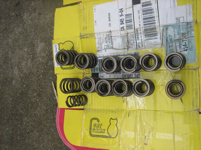

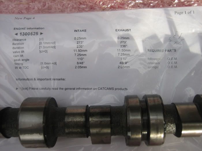

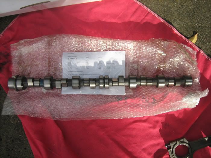

    I was going to stroke my motor and cam it with this, but I have since decided to go the s50 route. New cam and springs, never installed.
    I bought it from Surebimmer on Baye30.
    Here is what he wrote about the company.
    CatCam's 273/273 Brand New
    Catcams offer excellent performance and are considered by many to be more agressive than Schrick cam profiles. Based in Belguim, Catcams have been designing and manufacturing High Peformance Camshaft products for over 15 years.
    I paid 400 for the cam and the springs. I want to get that back.

    there are results on bimmerforums for catcams but its a 288, my 273/273 catcam is being installed right now, but unforuntely i can provide not feedback at this point. nice looking product though.
      lemme know how she feels.
