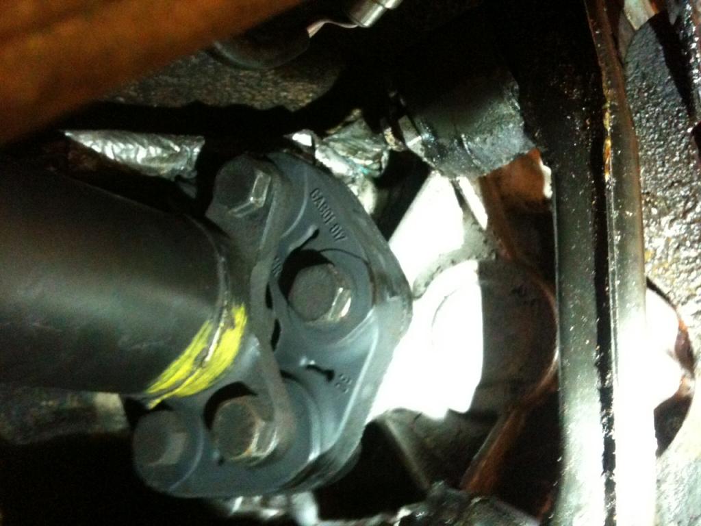

            • reelizmpro
              • 9558
              Take a picture of the output flange/guibo area and post it.
              88 M3 - LACHSSILBER
              89 M3 - ALPINEWEISS II
              • Davidov
                • Oct 2011
                • 78
                Ok, here's a picture.
                It is 135mm diameter, the "large" guibo/flange version. 12mm bolts.
