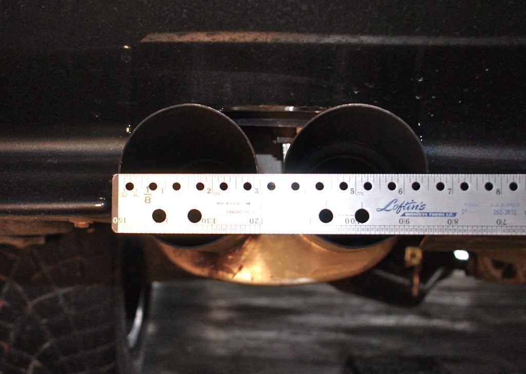

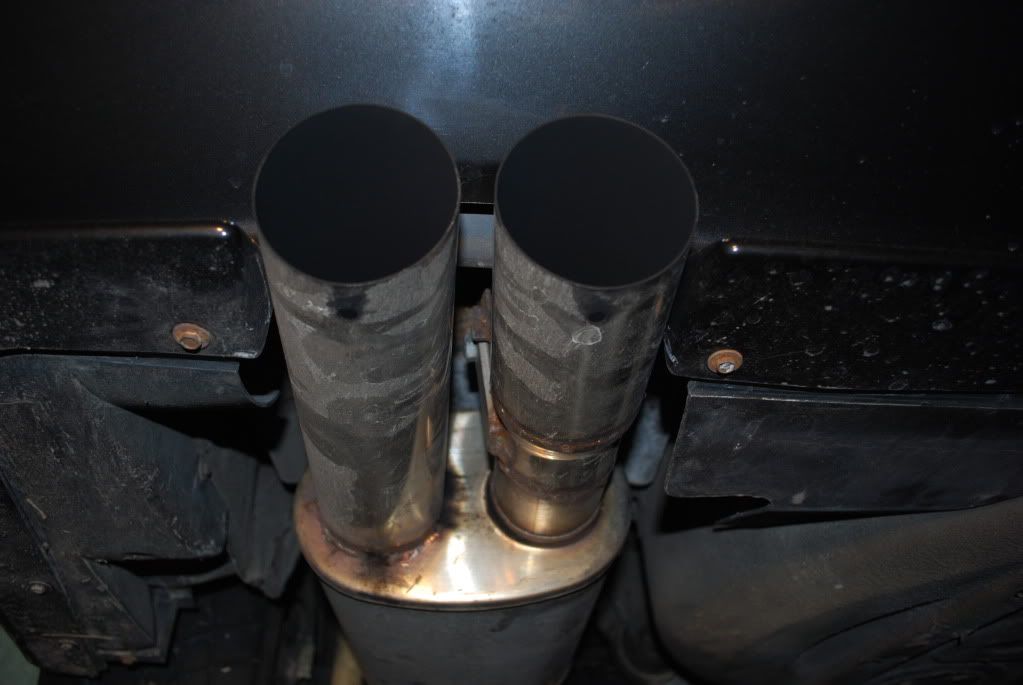

                              Here are pics of my magnaflow with 3" tips ghetto rigged to not fit. You can see the left just has a 3" sleeve over the 2.5" pipe, and the right just graduated to 3". horrible, and still doesn't fit.
