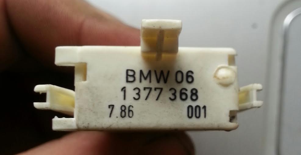

    What up guys. I have a coding plug from an unknown car
    Can someone tell me if this is from a 4 or 6 cylinder and if from a 6 would someone be willing to trade me for a 4 cyl. thanks

    62-11-1-377-368 Coding plug for 325e/eS -9/87 "06"
    62-11-1-385-580 Coding plug for 325e, 10/87+ "19"
    62-11-1-385-468 Coding plug for 325i "BMW 17"
    62-11-1-381-699 Coding plug for M3 "12"
    The 1,5,6,10 numbers are simply the connector pin numbers.
    Well looks like im in need of a 4 cyl plug

      Yea, that's a 325e coding plug for 6 cyl engine with 5k redline. I have many extra coding plugs including the one you need from a M42 318i. Shoot me a PM and I can get one out to you.
