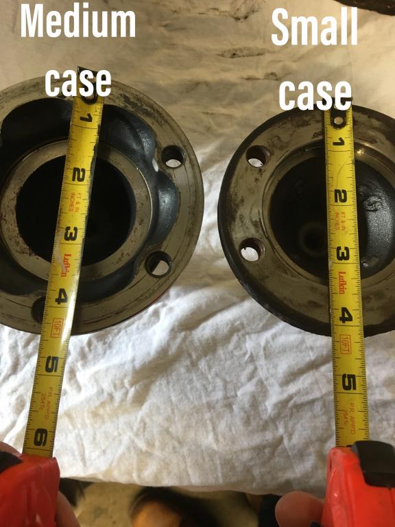

              Sorry, should have mentioned the issue is the output flanges. The medium case flanges measures roughly 4 1/2” and the small case flanges measures roughly 4”. I’m looking for a set of axles to mate up to the larger output flanges, or another solution to make this diff work
                That medium flange doesnt seem right. It looks like either the large case or from e36. Did you have 5 lugs?

                      You will need to identify what diff you have, which output flange, and which drive axle you have before. The picture you have with the 4" diameter is for e30s but can't tell if for small or medium case. The flange diameter is the same for small and medium e30 cases. The picture with 4 1/2" diameter does not appear to be for e30s. Make sure you know what you're asking for.
