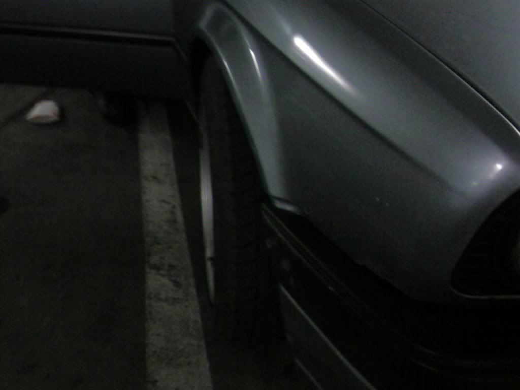

So love30 came through today with an assortment of small spacers extended lug bolts. good news and and bad news. 3mm spacers will not work with out some extra work. It looks like the 5mm spacers should do the trick but they are just long enough so that your wheel will not sit on the hub. That seems like bad idea. So what i did was ground off 2mm from the bracket and used the 3mm spacers. I like the look a lot and feel anything over 8mm will give it poke. If i wanted that i could have saved myself some time and money and got some sport max 16x8 et15 wheels. So i think i'll run some already existing 10mm 57.1 hub centric spacers that the vw crowd uses and i'll try a 8mm spacer up front. I'll take some pics tomorrow.

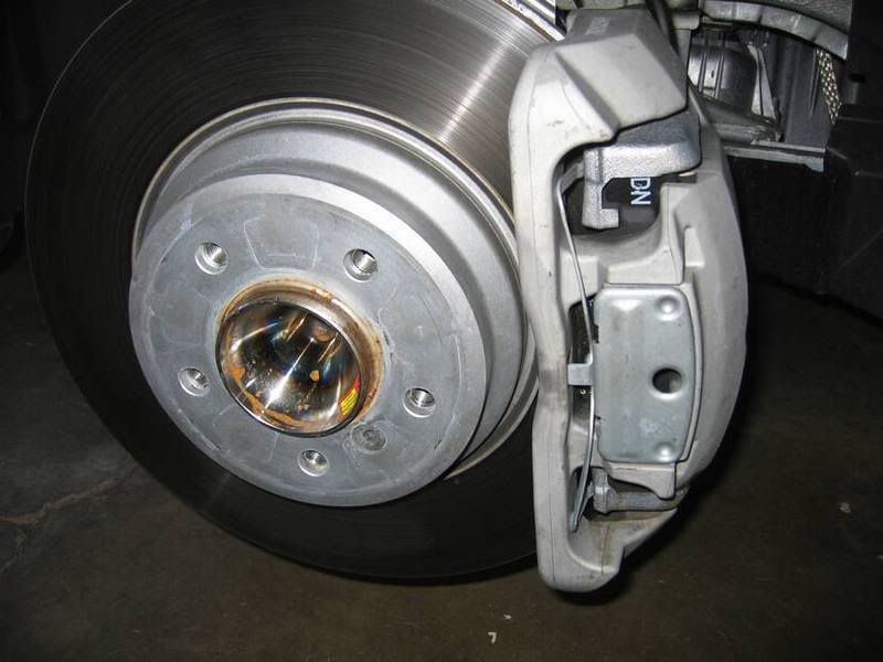

Here is my fiance's e60. (just a little bit newer than an e36)You say it looks scary and unsafe. but what you dont realize is that most new BMW cars are exactly the same way that I have cut my bracket.
So before you decide to speak, Maybe you should search. I know I wouldnt have done it if I didnt think it wasnt safe.
I will show this pic for ref. Its from an e36.
I can dig up more photos of BMWs that are exactly the same way.

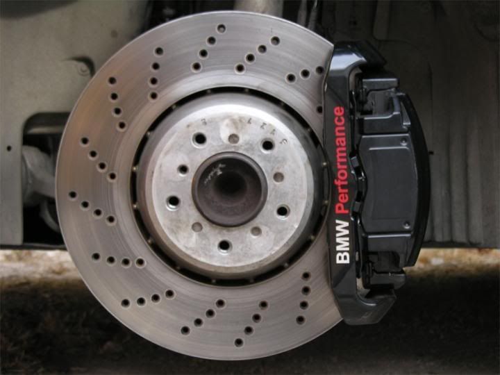

Here is an e60 M5 (just in case my finace's car is too low budget)
I'm sure the engineers who designed our brakes know more then you or I will ever know about them. Yes some BMWs don't have a brace across the front of the caliper carrier, but they were engineered to not need them.
This guy would not do this unless he felt it was safe either.
What you don't realize is for the last 20 years my father (BMW tech) has been showing me more broken bmw parts then i care to remember. Him and all the other techs would have pissing contest on who had the most fubar'd part. Also the fact that until very recently when i decided to complete my engineering degree, I was a total loss claims adjuster and have seen first hand worst case scenario outcomes.
I tell you what, show me a fatigue analysis of your parts compared to an original part. If their failure points are within 20% of each other and that 80-0mph stopping distances are consistantly within 5 feet of non butchered brakes and i will eat my words and bow to you as the all knowing brake master. Until then, maybe you should think before you speak.Last edited by einstein57; 02-20-2009, 02:05 AM.Your signature picture has been removed since it contained the Photobucket "upgrade your account" image.
