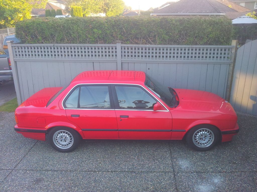

          Here is mine (vert kit): Back has no adjusters and no pads (not low enough). I didnt cut out my stock spring perch in the front... that being said my adjusters are spun all the way down and I want more low... I am hoping for a big settle. But overall I am happy with the set. The hardest part was to remove the stock shock from the strut housing. I had to take it to a shop that used an air hammer to get the stock shock out.
          Installing the JOM components went smooth but removing the stocks components was a bitch. I could have used a spring compressor for the rears because the trailing arm couldn't drop low enough and I kind of had to pry the rear springs out.
