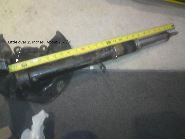

        What is wrong with this picture? I had (I thought I had) Bilstein Sport shocks with Eibach Pro springs. I removed the springs and trying to install GE setup (with IE camber plates). But, it looks like I have the wrong shocks!!! Has anyone have any pictures of their installation (not the car but the shock/springs/plates). Or any measurements?
        Thanks
        • einstein57
          • Jun 2007
          • 10780
          #1189
          That looks about right
          www.gecoils.com
          • Blackout
            • Apr 2011
            • 4130
            #1190
            LOL, those are bilstein sports indeed.

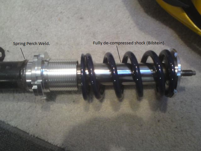

                Thanks for the confirmation - Great news (I don't have to buy new shocks). But, how do I install this kit then? Spring is too short. On my previous setup (Eibach -prokit) I had to compress the spring and the top nut on the top of the shock held the whole assembly together.Anyone have any pictures of these kits being installed on standard length assemblies) not shortened?
                Do I need to put everything together, then compress the shock and bolt it together? Thanks for any help (schematics would be great as well).
                • giantkeeper
                  • Aug 2009
                  • 1416
                  #1193
                  The spring isn't too short! When you install everything and set your car down it will settle and life will be good.

                    Yep, some springs are so short and stiff, that they are not under compression while the shock is fully extended. H&R Race springs do the same thing with Bilstein Sports, they have an inch or so of play. The shocks natural position is fully extended, but while on the car, the position is determined by the spring setup. When you set the car down, the shock will simply compress and once the spring is under pressure under the weight of the car, everything will work fine, just like stock.

                      Thanks for the replies,
                      I am still not 100%. Has anyone have any pictures of the shock-spring assembly off the car?
                      Something like this:
                      In the above picture, is the shock compressed?
                      Thanks

                        Dude, your strut is fine. That's the way it's supposed to be. Put the upper mount or camber plate on top, and put it on the car.
                        You'll see how it works.

                          When the strut is on the car, the gap will be taken care of. Adjust the height of the lower adjusters from there.

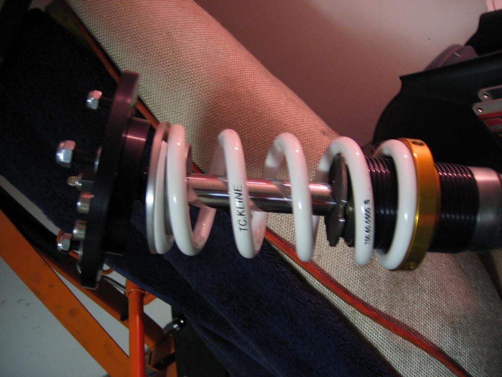

                                #1200
                                assembled pics
                                So I finally got my suspension installed, here's some lack luster pics. I will probably get some better ones tomorrow.
                                Full setup, ready to be bolted on (2inches sectioned out):
                                IMG_0457 by m_colby, on Flickr
                                Rear height all the way down, with adjusters in:
                                IMG_0468 by m_colby, on Flickr
                                Front height all the way down, with adjusters:
                                IMG_0467 by m_colby, on Flickr
                                *I would assume the springs will settle a little as well. I'm not currently driving at this height either, just wanted to see the full adjustment.*
                                89 325i
                                450/650lbs
                                IX HD bilstiens
                                2in. sectioned out of housings,
                                IE Camber plates
                                IE rear strut mounts
                                Flickr
                                @michael.colby on Instagram
                                "All he needed was a wheel in his hand and four on the road"
