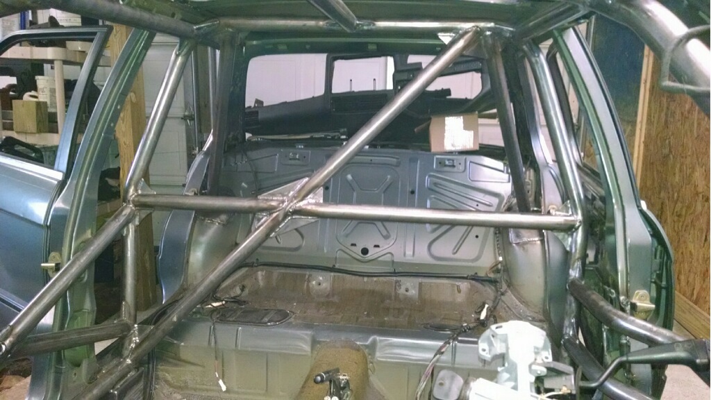

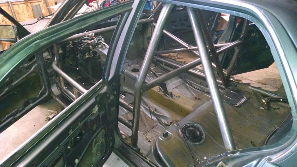

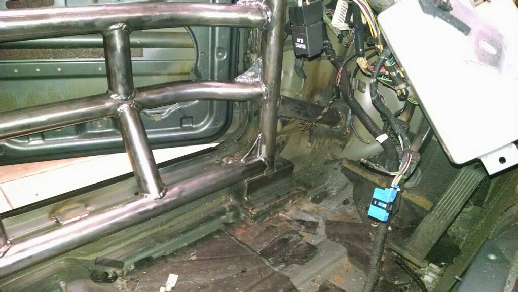

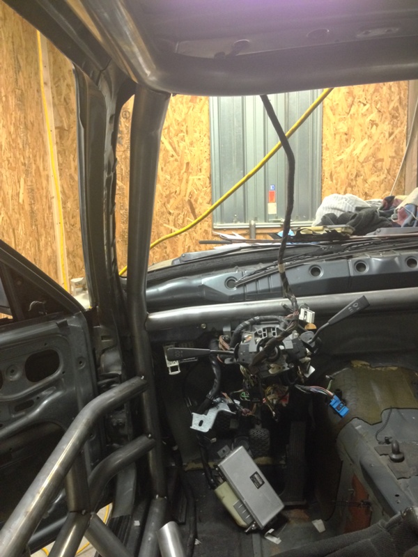

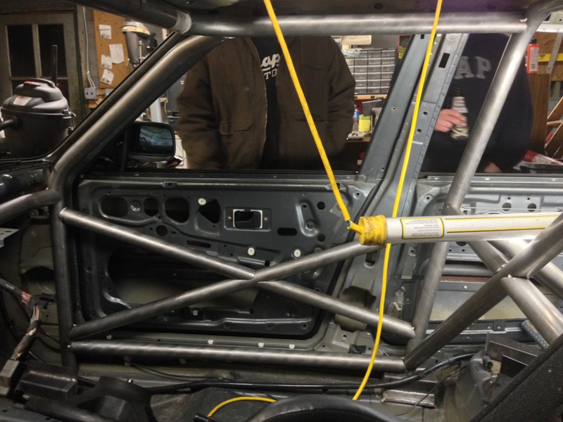

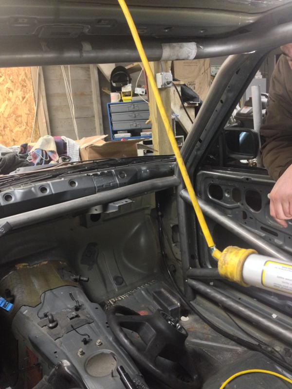

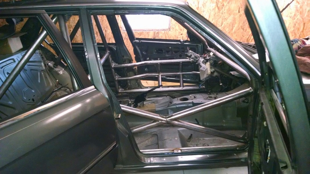

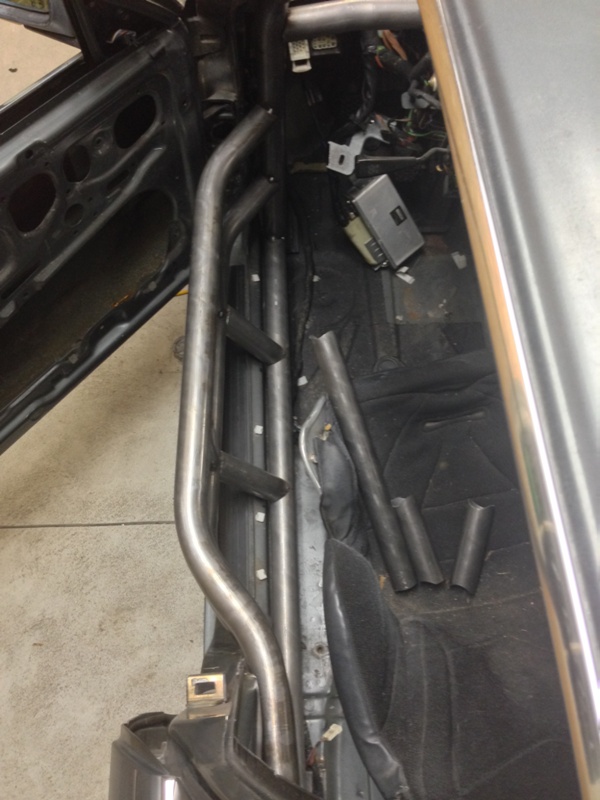

    Chris is a good fabricator, so he tackled the cage. We ordered a kit from rollcagecomponents.com, which required a fair bit of work to fit. That said, it is a very good starter kit, and worth the money. The cage is tacked in place and ready for final welding. That's where we are as of today. Hoping to have the cage finished in a few weeks, then we'll start getting the car back together.

                              Cage is finished. Engine is assembled with clutch/trans and ready to drop in. Still a ton of work to do in a very short amount of time... We haven't even touched paint/graphics yet, seat mounting, suspension/brakes, etc...
