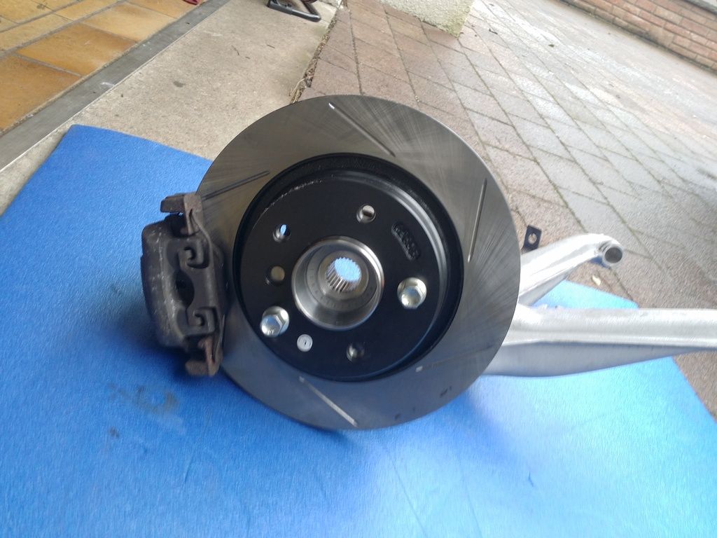

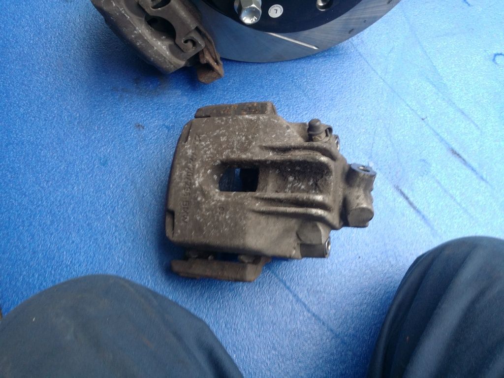

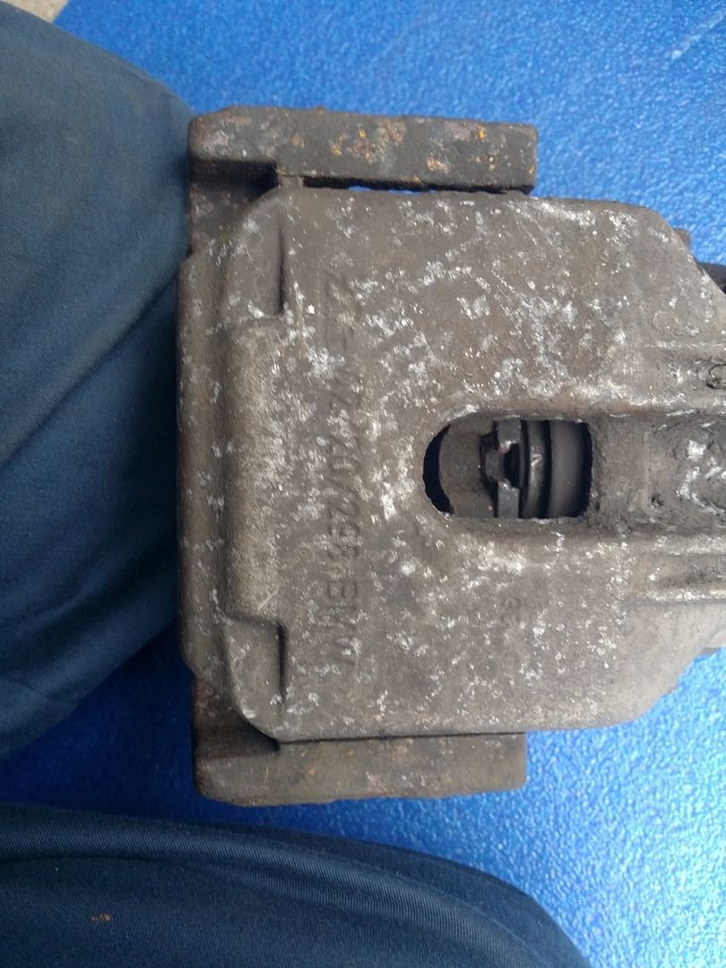

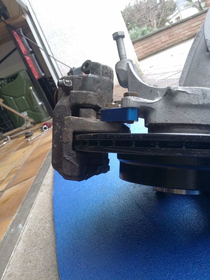

                          • Djmack
                            • Jul 2014
                            • 58
                            #268
                            CONFIRMED! Z4 Hubs installed WITH e39 530i rear calipers. (not 540i)
                            This is the Z4 hubs installed using the bracket provided in the kit with NO spacers installed. Although i might consider putting some small ones in there for better centering. In the last picture is a 3 position code listed on the top/front of the caliper that indicates the caliper dimensions. The 530i calipers have the same last two dimensions which is rotor size and thickness. As I've been told by a german friend, the first number indicates the brake cylinder diameter which would make this 2mm larger than the 540 calipers.
                            • peterz
                              • Sep 2005
                              • 74
                              #269
                              That caliper even has better brake line positioning. Oh well, time to swap out my 540 calipers for 530 calipers. Wonder why they are different...
                              • Djmack
                                • Jul 2014
                                • 58
                                #270
                                quick update: I didn't have the hub 100% seated in the bearing when i test fit this. This caused the caliper bracket to contact the rotor slightly. There were a few options i could have chosen to fix this issue but i decided to send my brackets to the machine shop to have them mill 2mm off the face of the bracket. It should allow the rotors to center in the bracket. Also, The e30 front brake lines used on the rear are too short for the calipers. My plan is just to use the short lines and fill the gap with a hard line and coupling. More pictures to come.
