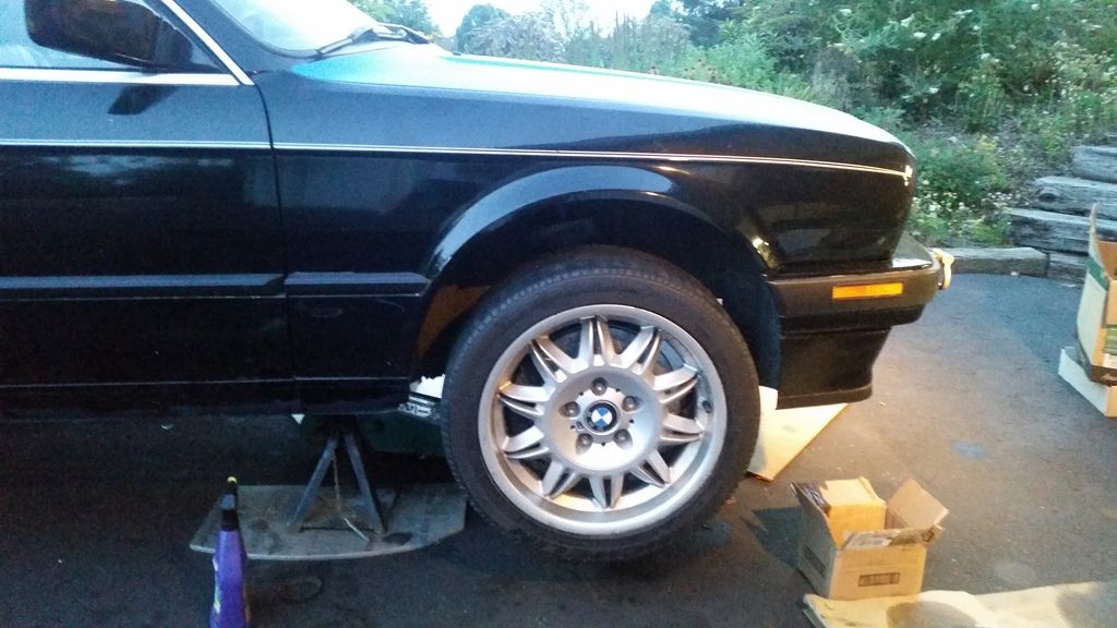

              #231

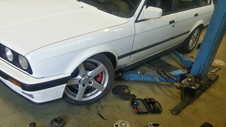

              While we are sharing pics...
              Got a front on today!
              I gotta torque the axle nut yet. Are you guys gonna do the standard e30 torque? (210 ft-lbs)
              Car has a way to go till it is on the road. pulling the engine this weekend O.o

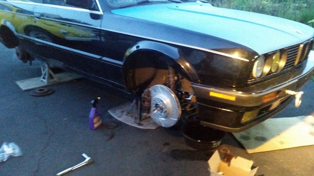

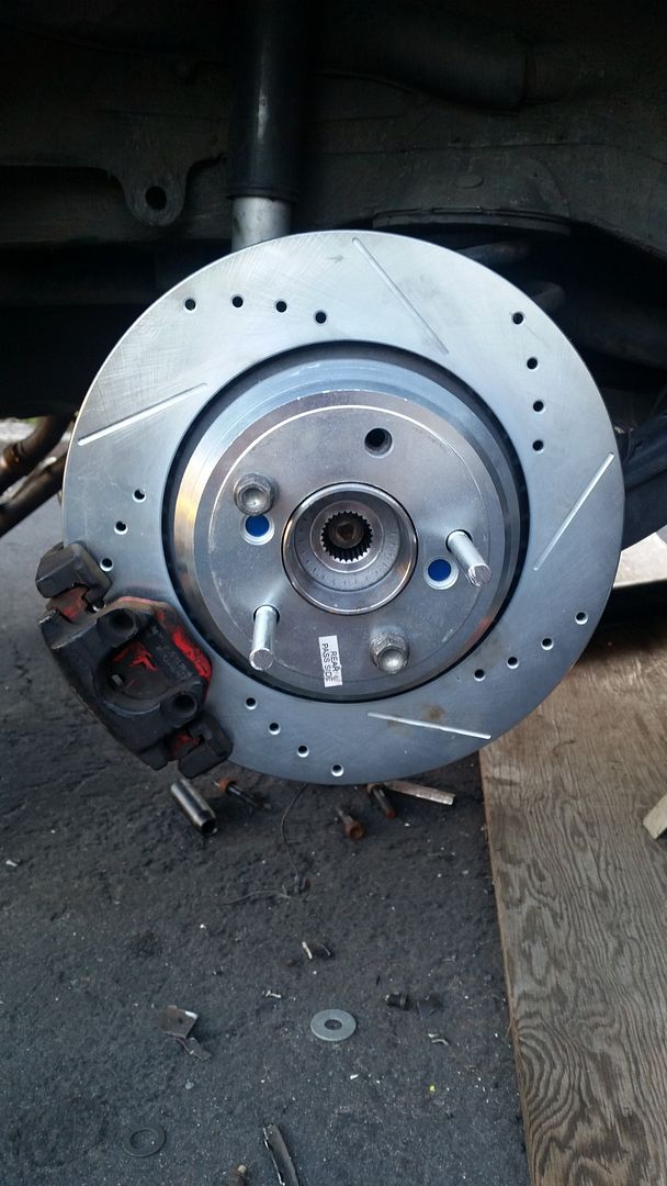

                #232

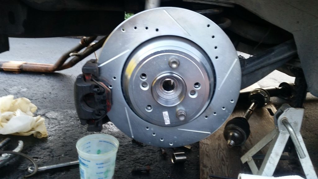

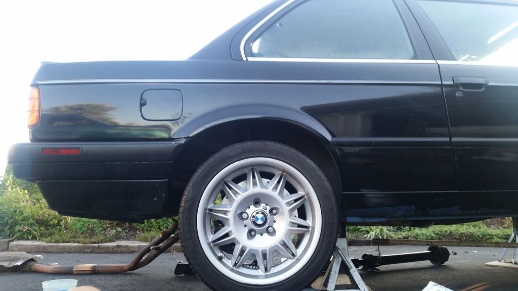

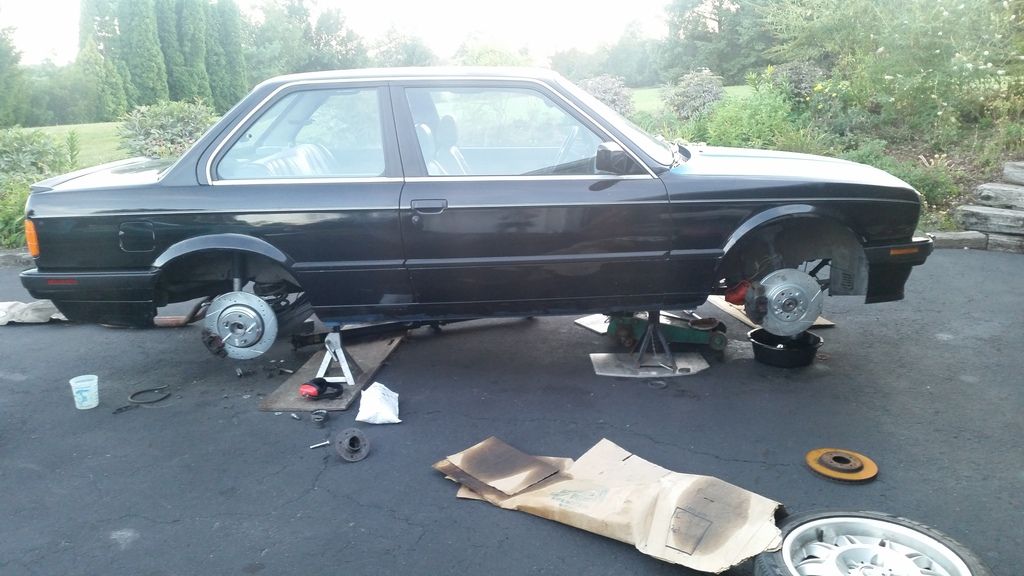

                So I got a rear on today. I used the Z4 rear hubs, and e46 M3 calipers/rotors.
                Here are some pics. I only got the one side in because I thought the bolt was the same as the front and didn't have any M10's arounnd...
                It didn't fit, the rotor was too far inside. So I started messing around with washers and putting them between the rotor and the hub on the lug bolts. crappy pictures below.
                2.5 mm of washers made everything fit, but just barely. The pic below of is 2.5 mm of washers. 4 mm seemed to do the best job of putting the rotor lined up in the middle of the caliper bracket. I'll buy some 4 mm spacers and report back...
                1989 325is
                1992 525iT w/ S52 swap - SOLD

                  #233
                  Looks good. For the rear, I thought you're supposed to get E46 325i rear rotors, not the m3 ones?
                  Did you end up getting the Febi z4 rear hubs or OEM?
                    Thanks!
                    I bought mine off ECS Tuning:
                    http://www.ecstuning.com/ES58046/
                    You are supposed to use 325i rotors/calipers. But there is a way to use M3 rear rotors and calipers as well but it takes additional work. It doesn't seem to be public knowledge yet as to how to do this. I guess the difference is the need for a wheel spacer. I'll finish putting them on this weekend and post more pics with wheel spacers in and come back with more pictures and a verdict.

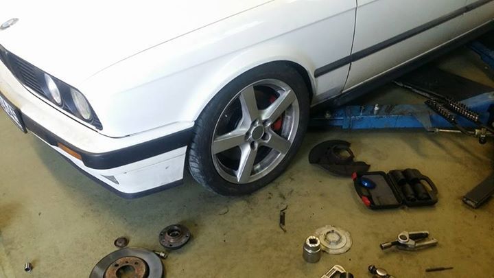

                        • Djmack
                          • Jul 2014
                          • 58
                          #237
                          Okay, so i almost had one side in today when i realized that i need either a 46mm or 1-13/16" socket.... thin wall. Also, i need to buy a lock-nuts and bolts for the front caliper bracket.. i was putting things together for test fit when i found out that there's no threads for the old bolts to grab. :facepalm:
                          Also, I should be able to use the existing brake lines with the e46m3 calipers, right?
                          (please respond quickly, i'm trying again in the morning)

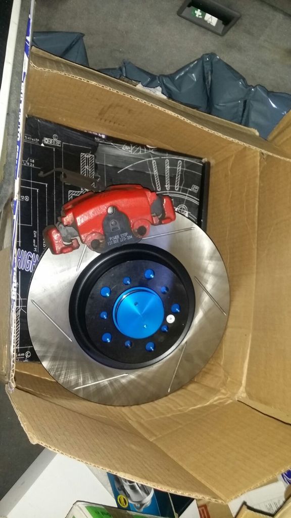

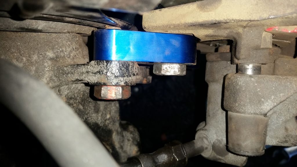

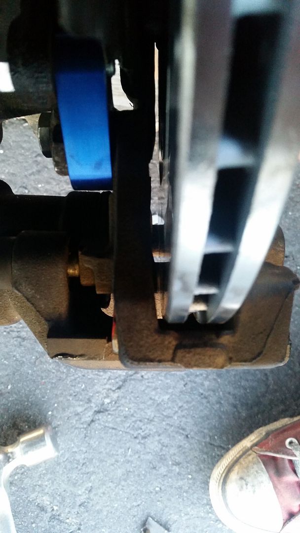

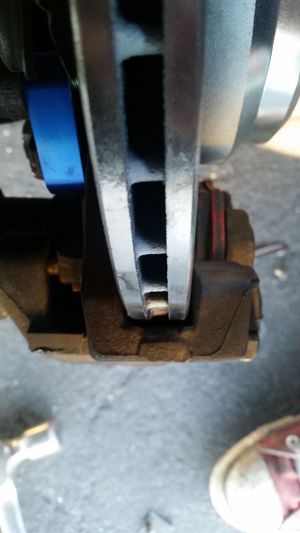

                              #239
                              Dude that wagon.
                              mmmm
                              So apparently there is no such thing as a 4 mm spacer, so I thought, well what if I try a 5? The spacers that came with the kit are just over 5. So i put one on. It rubbed in the front see pic:
                              and
                              So I'll buy some 3 mm. Also, you need to cut the shit out of the dust shield to fit the calipers.
                              Other than that the M3 rears are in.
                              Also gotta figure out how to make the parking brake still work. Any ideas? e30 one is too small.

                                #240
                                uhm sorry for the giant pictures.
