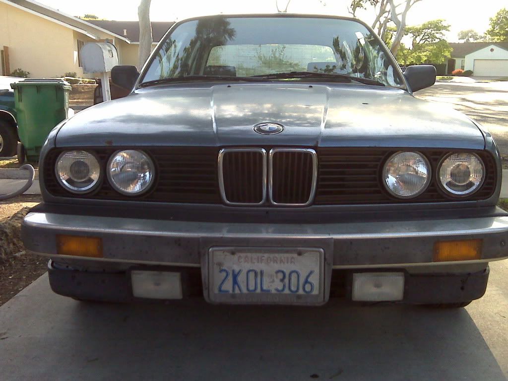

    SEM 39143 black trim
    After:
    15 bucks. Good product. Supposedly blacks out the trim and protects it (unlike rubbing compounds etc that will only temporarily put some life back into your trim)
