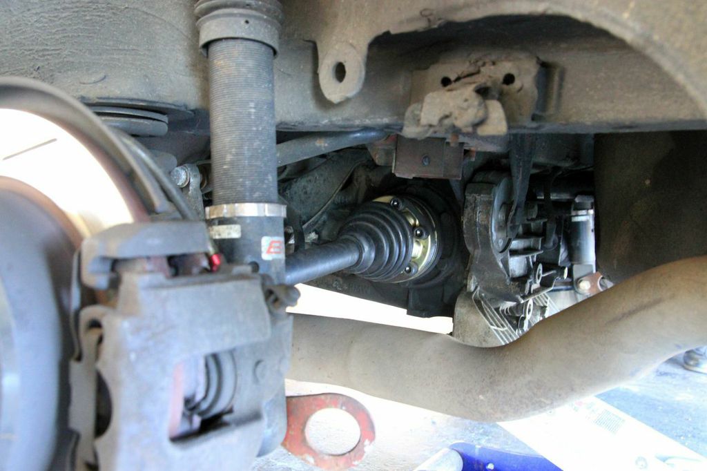

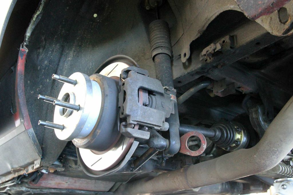

                        #71
                        How many of you have installed your axles? I finally got around to installing mine, and noticed that on one of them, there was a bit of play on the splines. Normally you have to do a bit of cleaning with some degreaser and wire brush, sometimes even a small file, to even get a stock axle to slide into the hub. On one of these CA Tuned axles however, it literally falls into place and there is noticeable play in the splines. Not a huge amount, but enough to visually see movement, and hear the play as well, as you hold the axle, and roll the hub back and forth. Obviously, this play disappeared when I tightened the axle nut. I'm just a little concerned about longevity of the splines and/or the nut coming loose over time due to forward/backward rocking of the splines under hard accel/decel. This was an axle specific clearance issue, not the hub.
                        Just curious if anyone else noticed this, or knows if this is a potential problem.

                          #72
                          Their shouldn't be any play.. Perhaps it was your hub the problem all along.
                          Are you using the same hub you damaged your other axles with?
                          • JGood
                            • Jan 2004
                            • 7959
                            #73
