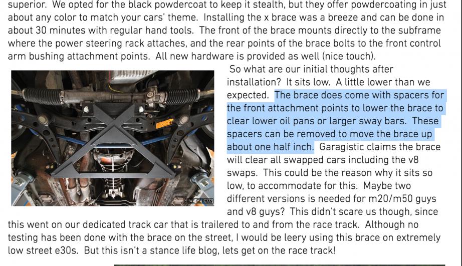

                Edit; Few pics. Here's a iPhone 7 on it's side and a pic of my ride height. The X Brace is somewhat parallel with your front wheels, so in other words when your moving slowly over a speed bump, as soon as the front wheels start to travel up/over the speed bump, your X Brace also travels upward and away from the bump. The issue is when you don't go over the bump with your front wheels and try and center the car so the front/rear wheels avoid the bump completely. The brace hang's low enough to which you might scrape. Hope you guys get what I'm saying.
                Lastly, I'm not using the spacers pictured on page 2, second pic "Haystack" posted. They're optional and if removed bring the X Brace up about half a inch. I also used all the factory hardware cause mine wasn't included with any.

                  Stock front swa bar? I have a thicker UUC front sway and without the spacers it was a bit too close for my liking.
                    Yup just a stock convertible sway bar here, I can see why you had to use the spacers then.

                      Installation, as others noted, can be a little fiddly. All the mounting points are slotted, but they are TIGHT. I had to use a jack at a couple points to get the bolt holes to line up enough to tighten with fingers at least 2 or 3 full turns. I've stripped out CAB lollipop mount holes before and while helicoiling is an option... I would like to avoid if possible. I did not use any of the included hardware. I re-used the factory stuff with no issues. The included hardware just seemed way too long, especially since I did not use the spacers.
                      This should give you an idea of clearance. It sits low, but I've only hit it once on a speed bump. Mostly because I am still getting used to it being there. Gone over many speed bumps but the only problem children are the tall and short variety. And even those clear if I go slow enough to not compress the springs on the other side. The longer/wider ones seem to have no problem clearing.
                      They clear my cheap ebay long tube headers easily so I have no negatives to report really. Extremely pleased with the purchase and really helped with the chassis flex of the vert. As mentioned, much quieter now in terms of chassis movement and twist. I am running on H&R sports with billy HD's and couldn't be happier. Will be purchasing their strut tower bar... and further in the future their reinforced subframe and maybe front sway bar.
