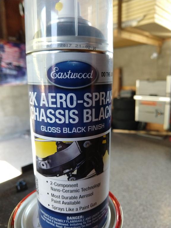

    Eastwood 2k Aerosol sprays
    I tried this to paint my re-worked trailing arms and subframe. Powdercoating was fancier than what I wanted, but I didn't want Krylon, either.
    The Eastwood 2k sprays are about $20 and are true catalyzed paints, more like epoxy than paint. It sprays nice and is tough as nails. It looks identical to the factory finish.
    You do need a respirator to spray it. Highly recommend!
