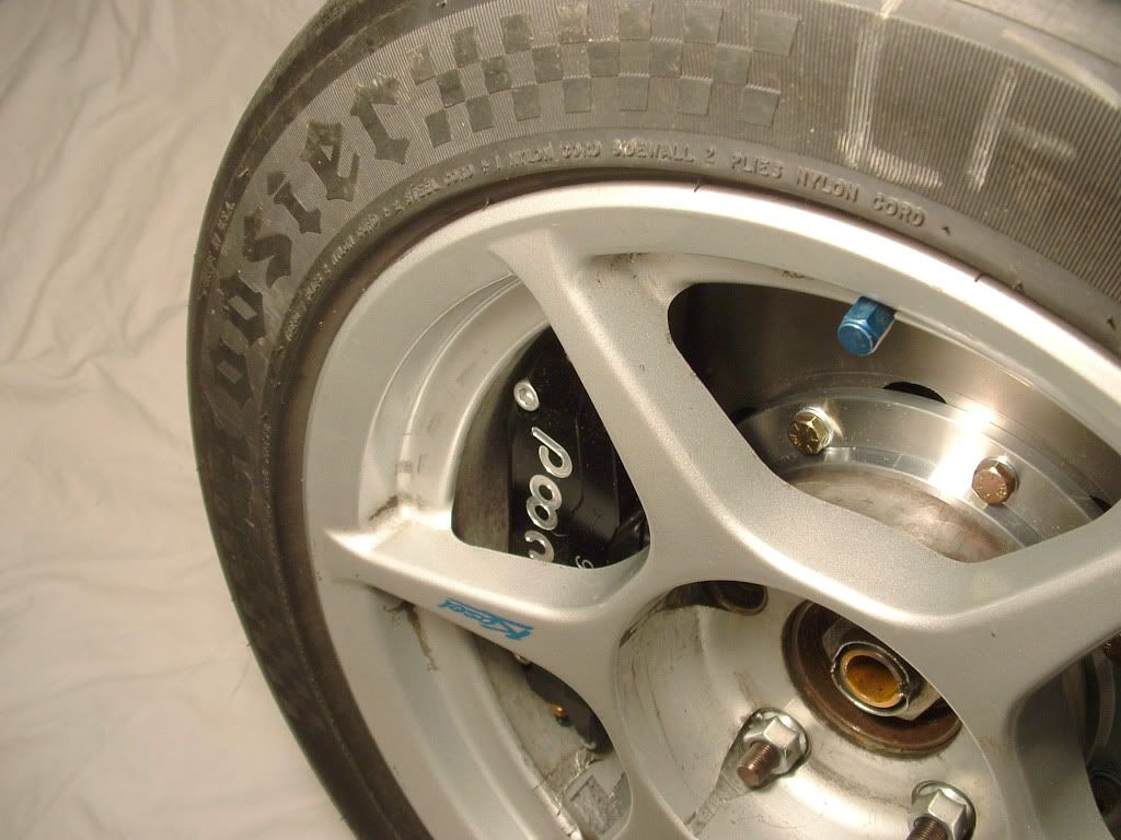

        Here are a few shots of the installed kit in Phil Abrami's 15" x 8" Kosei K1 (Thanks Phil for letting me borrow one of your wheels).
        Installation is a direct bolt-on. No wheel spacer or shim is required.
        Lateral clearance with the spokes is 3/8" (near the hub) to 3/4" (away from the hub).
        Radial clearance with the barrel is 2,5mm (a bit less than 1/8") at the closest point. It requires to relocate the balancing weights.

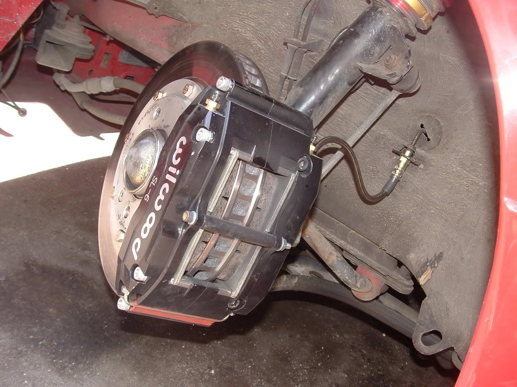

              Here is an update about the M3 rally kit with 11.75" x 1.25" rotors and 6 pots radial calipers. I tested the fit with some 16" x 8.5" Hartge wheels (et25) that are usually rear fitments. All it needed was 12mm or 15mm spacers to clear the wide calipers. Upon installing the kit on my own car, I realized that there were major discripencies in Lemforder control arms castings. One side was clearing the disc generously, while the other required to grind 2 or 3mm off. Only a two minute operation, but still bugging. I installed some Wilwood Q Compound brake pads and tested the kit for a full day on a brand new track called Calabogie, in Ontario. I ran the kit with no air ducting. The results were quite impressive even with some Toyo RA1s in 235.40.17 size. Lap after lap, session after session, I had prefect modulation of the strong brakes and could lock them at will. Even the cheap Wilwood pads ($75 vs $180 for PF97-01) were doing a great job. With the PF97s, they were too strong and required to be extra carefull. I did 4 sessions and still had a firm pedal at the end of the last one. No overheating to kill the fluid. The brake bias was perfect. Never did I felt that the back end was twitchy. I could brake hard in straight line, or softly trail brake, without feeling any unbalance. Having predictable brakes allowed me to drive hard in full confidence. I highly recommend the Q Compound as it generates limited friendly dust, is smooth on discs, don't squeal, and can be used on a daily driver. And it is very cheap. The best of all worlds. I have two sets of expensive PF97s that I won't probably be using anymore.
              That kit is the perfect options for those who attend driver schools and races, and don't want to got to the bigger 13" kit and rear 12.2". At under $1500usd + pads, they also are great value. Especially if using Q Compound pads which makes the kit more economical that using PF97-01 on the long run. Calipers with stainless pistons are also more enduring than street calipers with rubber dust boots, which melt and crack under extreme heat.
              Here are a few shots taken after the event.
