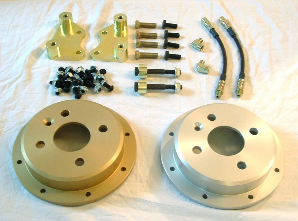

    Here is what the components for the rear 2002/e21 race kit look like. To be used with a BNDL caliper and 11.75" x 0.81" discs.

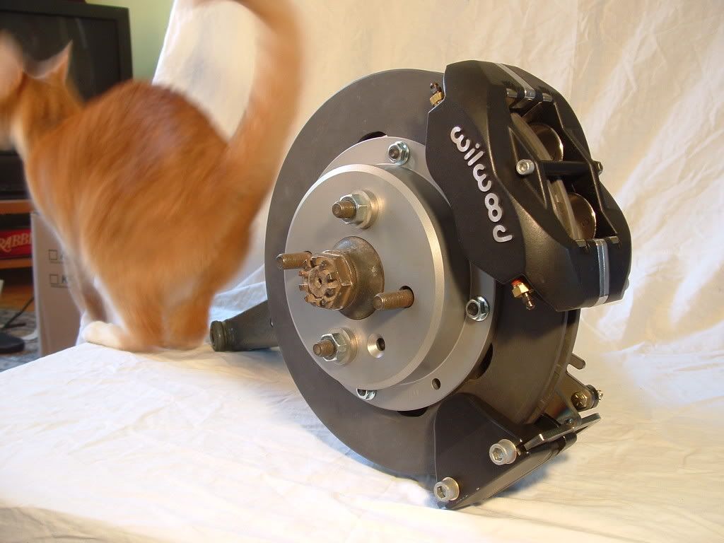

    And how the 2002/e21 rear kit looks, installed with the optional eBrake. Photo for test fitting only. Some bolts are missing, but my cat had approved the kit.
