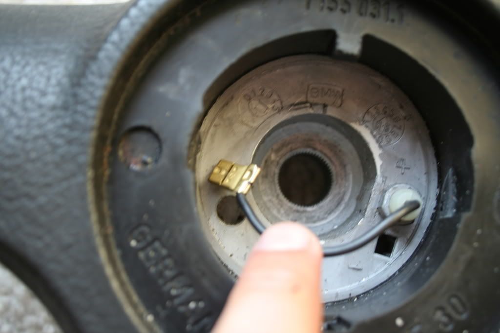

    First pic:
    -Thats when I had installed in with that clip, pressed it down and nothing happened.
    Second pic:
    -Moved it down to the bottom clip and same thing, nothing happened. I press it down while car is both times and nothing

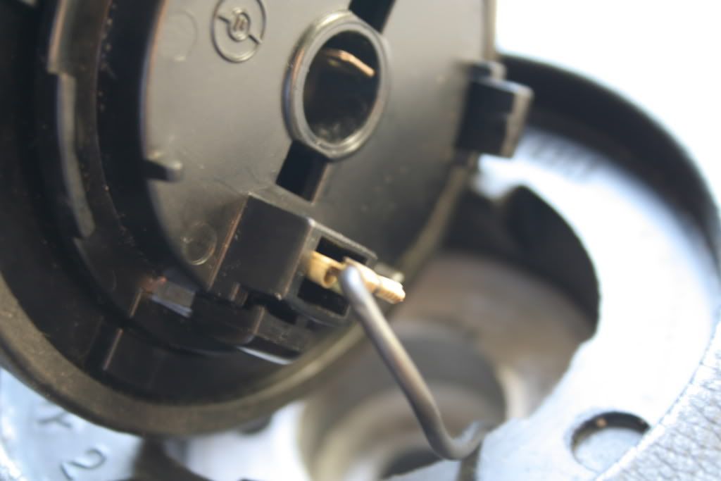

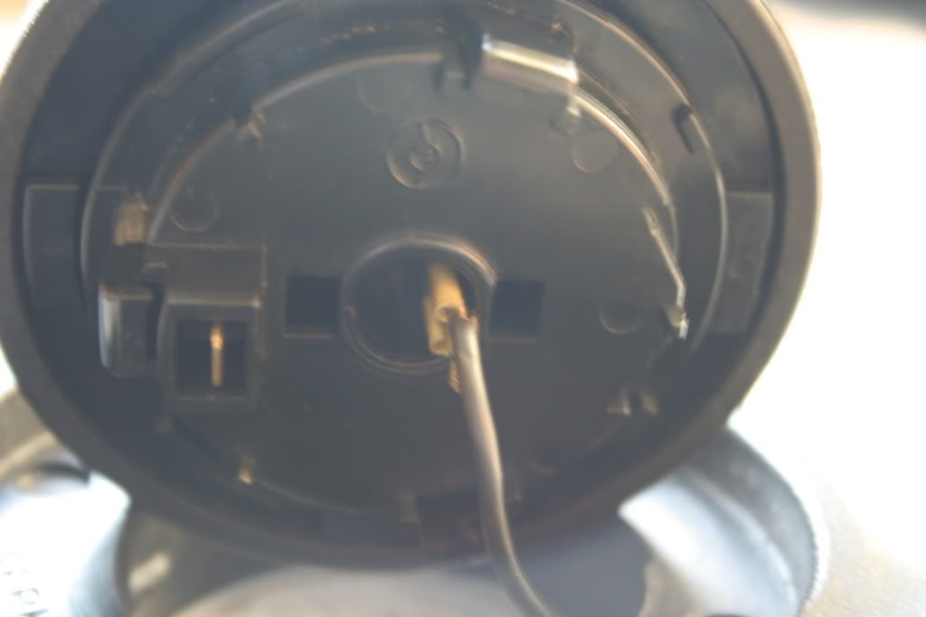

    Third pic:
    -This piece is touching the metal and while the car is on the horn works BUT its not connected to the actual circle "bmw" piece. And I'm not gonna drive around with the wheel not fully assembled and have to tap the metal piece just to make the horn work.
    So there is something defected in the round "bmw" piece that snaps to the wheel. Whenever you refund me , could you please just send me a PM you did so.

    Ah, there's your problem Steven - You see, the wire you're currently hooking up is the grounding wire, notice that you only have one wire connected to one of the "terminals" - I had this issue when I first tried installing the steering wheel a while back - the reason your horn isn't working is because the wire you connected right now is the POSITIVE wire (note the + next to the wire that comes out of the wheel), all you need to do is grab another wire that'll hook up to the OTHER terminal (the one that wasn't occupied - it will touch the metal ring in the steering wheel and GROUND the connection, thus causing your horn to go off - if you don't believe me, try it with a paper clip.
    Sorry I didn't mention this beforehand, especially since I had the same issue before - thankfully it's a $.25 cent fix.

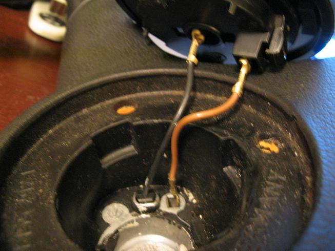

          Um, correct me if I'm wrong but that horn button needs 2 wires coming off of it. One to ground and the other to the horn wiring.
          • JasonC
            Site Manager
            • 14451
            Yah, here it is.

                as I stated before. I got the second wire. it still doesnt work. the wheel was installed and the car was on and when I went to go press nothing happened. what am I not explaining clearly?
