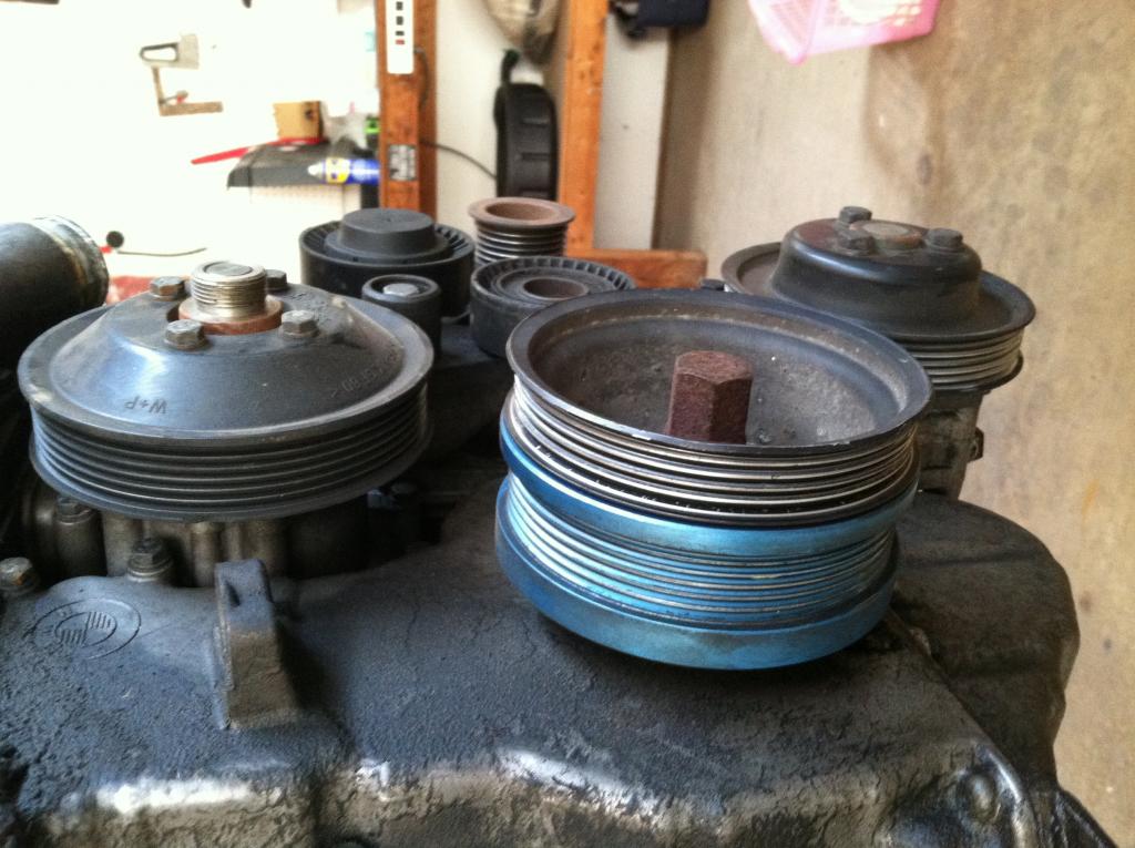

    Hey this question might be stupid so take it easy on me. I bought a s52 motor from a guy who parts alot of e36's. It did not come with the harmonic balencer on it but the ac and crank pulley where back on it bolted up as if it works. Ive noticed that with this crank pulley(seems big ass shit) and doesnt seem to be any space behind the pulley for the hb anyway. Help me thanks

    If you want to have an engine that stays intact, YES.

        Scary. I can see a lightened to a small degree but it needs one in a six to dampen the throw harmonics.

          Looks like an underdrive OBD2 pulley

            I know it is scary. I was just gonna chuck this motor in. I'm pretty sure that you can't run the engine without it. The scary part is why was it off in the first place. And why would someone take it off then put it back on. Lol.. O well thanks r3

                  I bought an S52 that came with one of those non-dampining underdrive crank pulleys. When i went to switch the oil pan for the swap, the oil pump nut was sitting in the bottom of the sump. Did the lack of balancer cause the nut to come off? maybe, maybe not.

                    You have to have a harmonic balancer. As previously stated it dampens the throw harmonics, or to put it in english it balances the engine. Most inline motors have one of some sort. I'd be wary of that motor. Definitly run some tests on it before you drop it in the car, could be completly trashed if someone was running it with out a HB.
                    You have to swap the oil pan anyways if its going in an e30, so while you have it apart, take a look at the crank shaft and rob bearings and the what not. Make sure everything is torqued properly and spins correctly.
                    The last thing you want is to go to all the trouble of doing a motor swap the motor being shot. Its happened to me before, back when i was young and a bit of a newb to mechanics.

                      Yes what everyone else said is correct about needing the mass to dampen and match the harmonics the motor creates to eliminate vibrations and noise.
                      Your bigger problem is that your motor needs atleast the outter ring of the balancer because that is the tone ring for the Crank Position Sensor (CPS) to read from and know where the crankshaft is. Hens the empty bracket right above your pulleys.
                        Nope, on the S52 motors the CKP is mounted to the block under the starter.
                          Ahhh you are correct. I looked right past the S52 in his discription and my mind went to S50.
