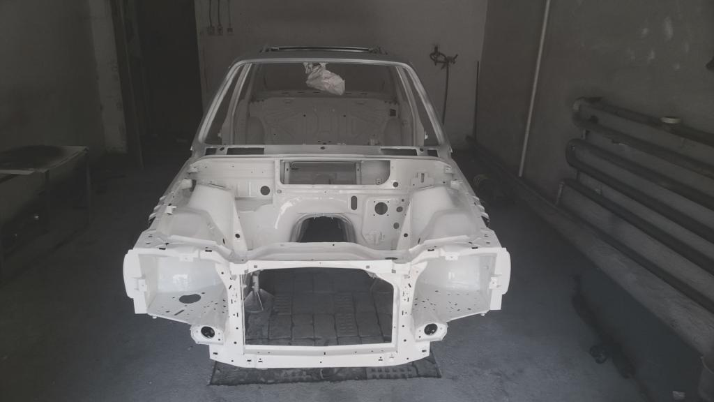

              There is a few more progress made to the car, we have the interior painted, and the parts for the suspension arrived as well.
