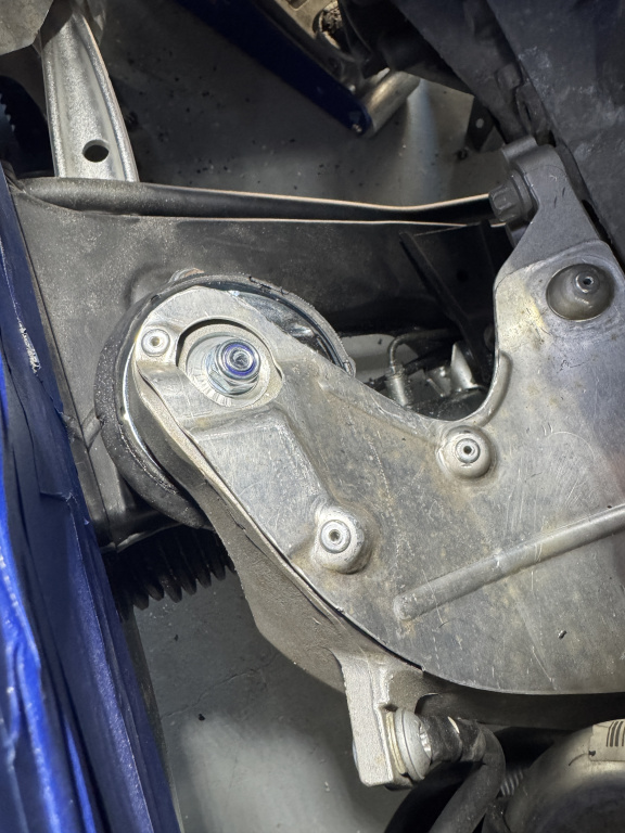

    I just installed the e46 mounts (upside down) with my N52, they move the engine back a few mm from the AKG location. I did cut off the locating nubs, they interfered with the engine arm. I also had to thin the engine arm a few mm and order thin lock nuts, couldn't get enough threads to feel comfortable.
    I haven't driven it yet but hoping they are a little less harsh.
