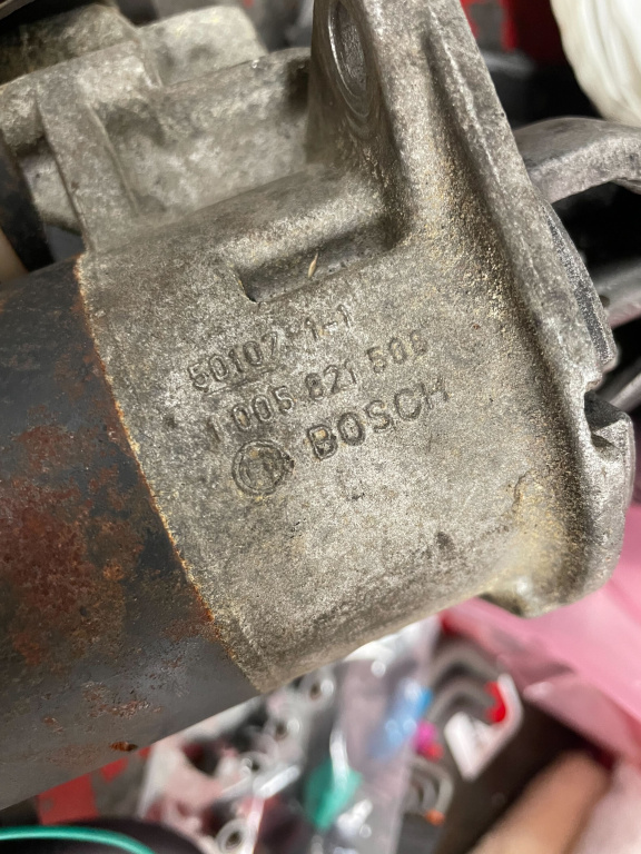

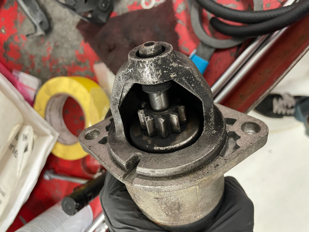

    For context this is the starter I am using. I'm 99% sure it's the one that was in my car when I got it as an auto.

      Solved. I had mixed up the starters and was actually using an M50 starter. Got an M20 starter and it cranked no problems
