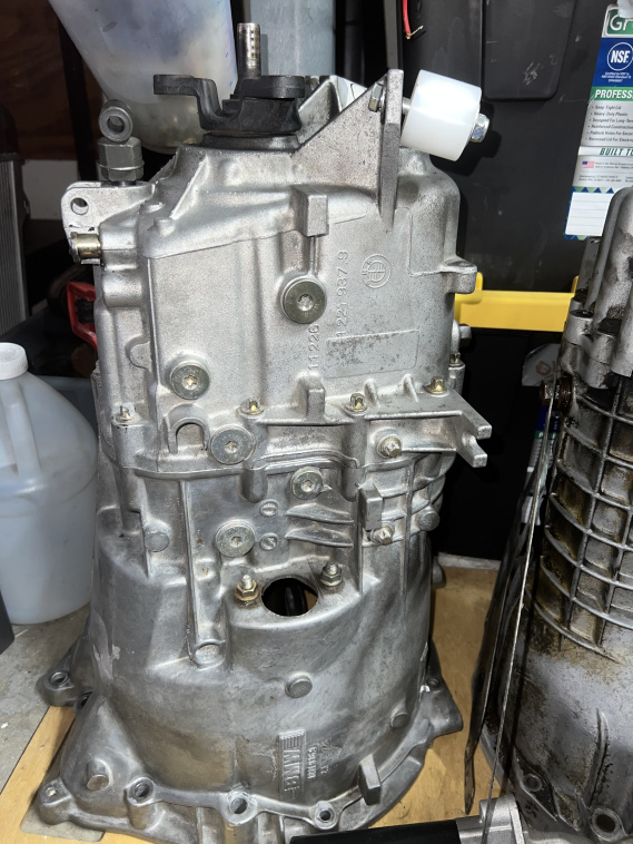

    Got a killer deal on a ZF 5 Speed transmission for $350.

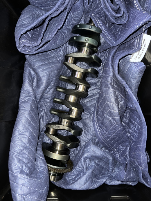

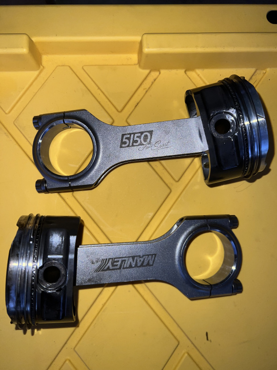

    The gentleman who sold me the transmission absolutely blessed me after hearing some of the troubles I’ve been having with my engine. He gave me an S52/M54B30 crankshaft along with some forged Manley Connecting Rods and forged Carrillo CP pistons! No charge! Now I have a whole forged M54B30 rotating assembly to install into my block to make a 3.0L M50 Stroker!

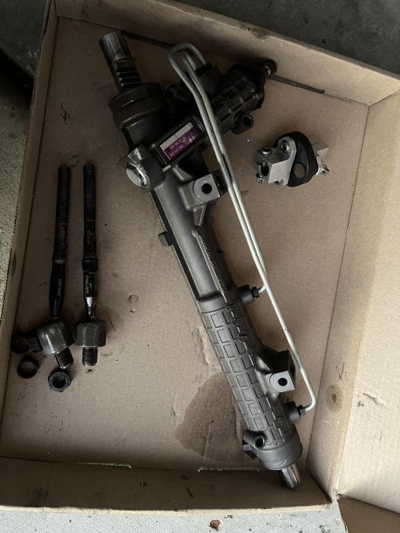

    Earlier this week I also got a purple tag E46 Rack for $180

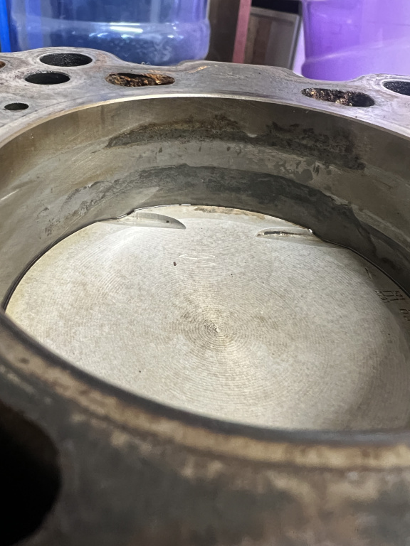

    Now looking for a competent machine shop which is fairly priced to help me install this rotating assembly into my block! Which unfortunately I found this in my cylinder 3 wall. Hopefully the overbore for 84.5mm pistons take care of it! The rest of them look cherry.

      Holy smokes, that is a fantastic find. What a nice guy. I did a pretty similar thing, putting that crank in my M52 but kept the M54 pistons.

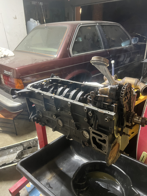

        This is where I am currently at!

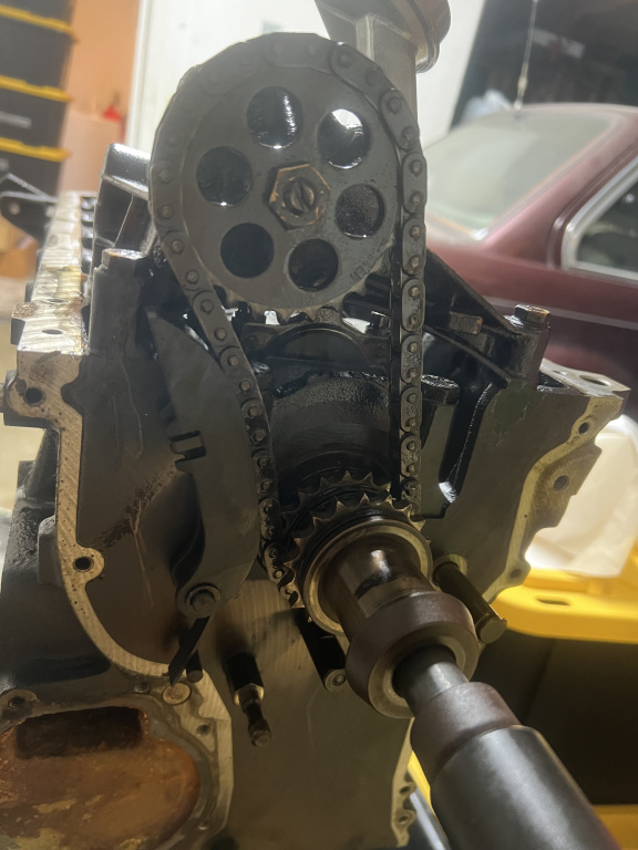

        Looks like my engine has been apart before, this oil pump chain tensioner isn’t factory, correct?

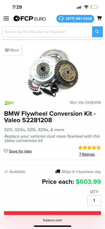

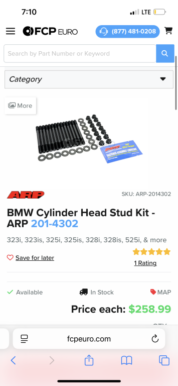

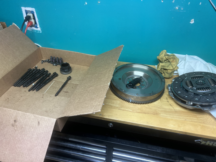

              At this point it feels like I have an addiction to stock piling parts… The deal was too good to be true again. ARP Head Studs and a Valeo Single Mass Conversion flywheel and clutch.. for $150…

              Just need the washers for the ARPs. I got some conflicting information, some people were saying use factory headbolt washers. My understanding was to use the washers supplied with the head stud kit.

                Ya should be fine with 215 without reinforcing the chassis, I haven't swapped a 24v into any of my cars yet But I know the early 318i's so well now that I can help ya when it comes to the weakness points, It also helps that if your head bolt kit comes with washers, you should use them.

                  Got my head bolt kit free with the clutch and flywheel. I am going to call ARP and get the part number for the replacement washers and order the right ones.
