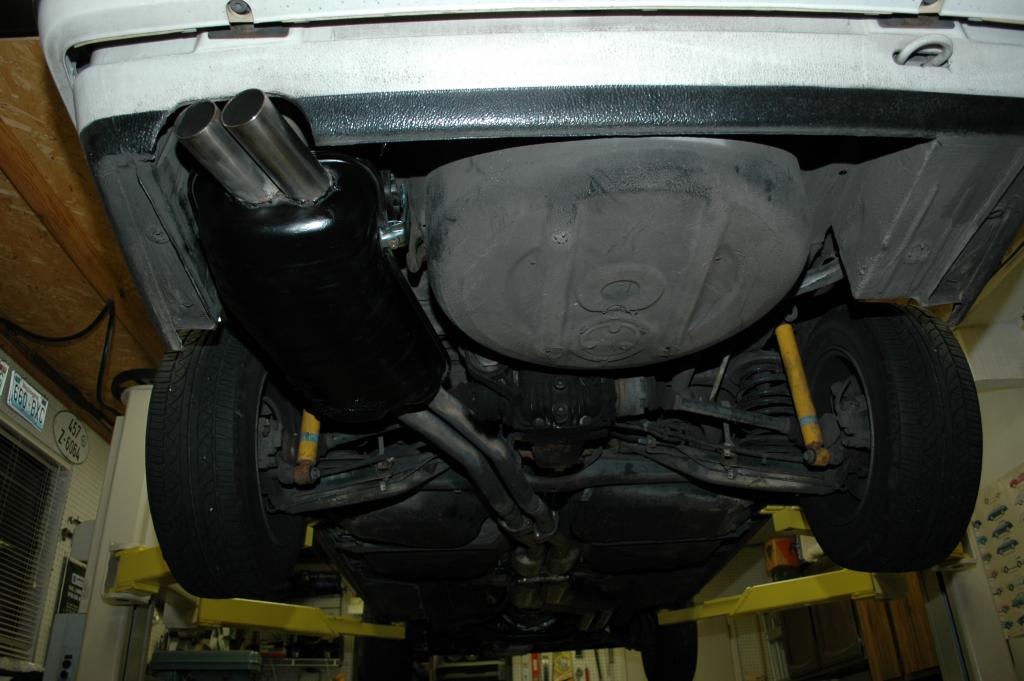

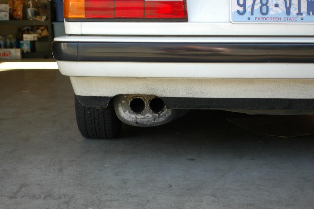

    Here's two pictures, the first shows how the holes line up to the edge of the valence and why the tips won't fit without modification.

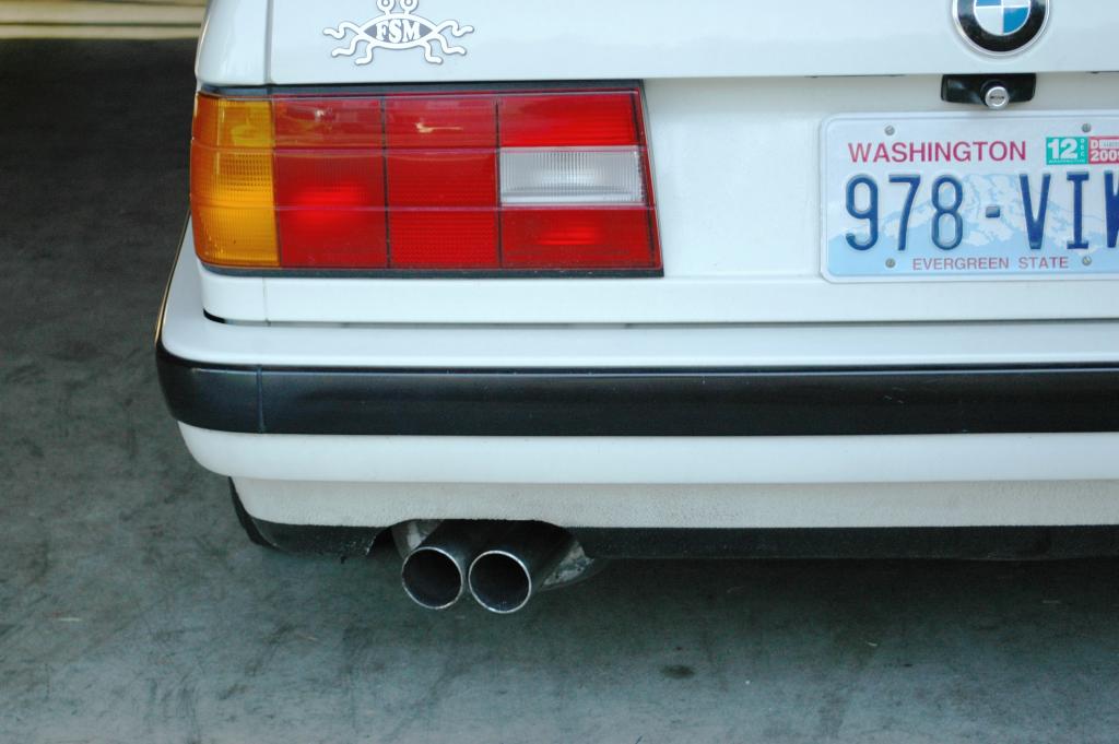

    Second is after they're glued back on at about a 20 degree angle. They're perfectly centered in the valence and I like the tilt to the side better than sticking straight out, anyway.
    I'll take the muffler off and repaint it at some point.

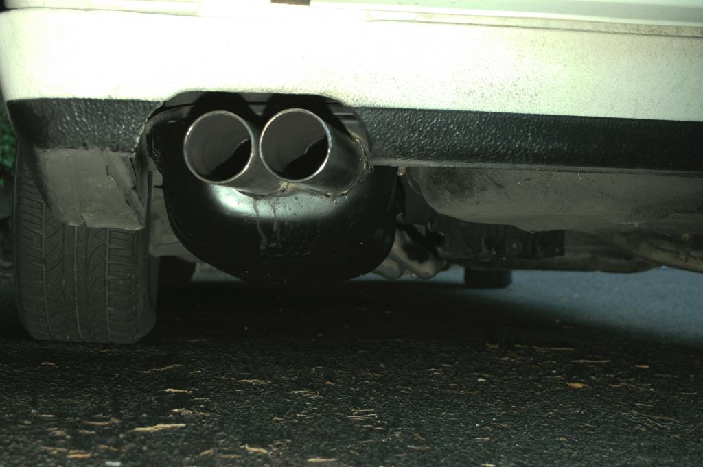

        Hoveringuy if you could snap a lower picture to show how much it actually hangs/tucks from the rear valence it would be much appreciated!
        Also, how did you mount it? When I had plans to run my 98 m3 muffler I was going to use the e36 muffler mounts and retrofit it using the e30s donut hanger and cutting it half way and using the male portion of the e36 mounts and have them welded. So this way I could hang it using the retaining metal/washer with the nut.

            It looks slightly like a pregnant guppy from the back.
            To install it, I used the stock O-ring in the front and welded the hangar to the e36 clamp. I bolted the complete e36 hanger through the floor trunk for the rear location.
            I got to follow my own car yesterday and it sounded pretty nice. Not loud or obnoxious in any regard, but a nice growl and slight popping on decel. No highway drone or raspiness whatsoever. It's a heavier exhaust, but it sounds quality.
            BTW, I was following in my brother's 993. I could keep up, but had to lean on it pretty good.
