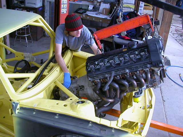

                The headers I want:
                • MIKe30
                  • Sep 2006
                  • 2334
                  Originally posted by hoveringuy
                  The headers I want:
                  +1. those just euro headers or the infamous kromer kraft headers?
                  btw, that build in that pic looks absolutely insane.
                  • e30this
                    • 3580
                    OMG thats hot, build thread??
