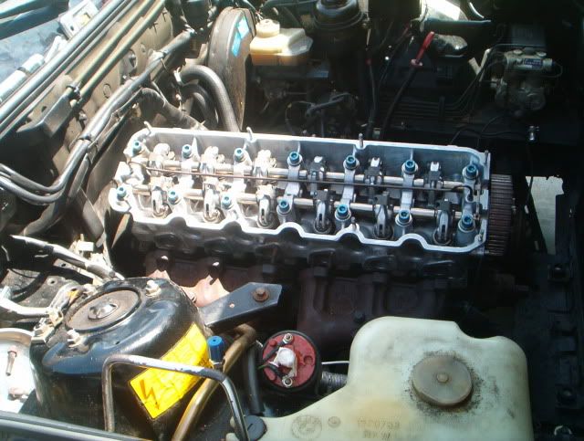

    1) My master cylinder has some sort of proportioning valve plumbed in below it that mounted to the two bolts holding the master cylinder to the booster. This thing does not want to fit back in place with the new master cylinder bolts - due to the attachment points being angled and further apart. The swap engine bays that I've seen pictured don't even have this thing. wtf?

            I should have taken some pictures while I was there. I'll work on that. My MC is an ix unit and it has 2 holes for the hardlines and 2 holes for the reservoir. However, my stock MC had some kind of unit mounted just below it that is made of the same construction as the MC itself. It has two short hardlines that go directly to the MC. The two hardlines coming from the car itself mount into this unit in question.

              This old pic shows the thing mounted under my master cylinder

                I'm not using the ix booster, however we have removed that little valve on the swap cars and have had no issues.
                  so you just take the hard lines that would have gone into the little valve and pipe them into the MC?
                  which line goes into which hole on the MC?
