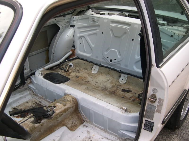

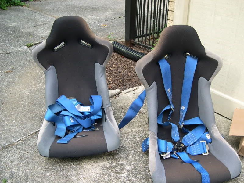

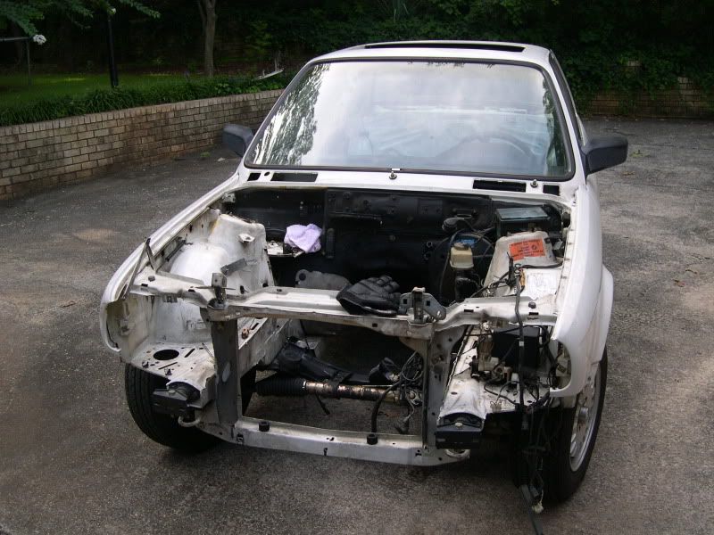

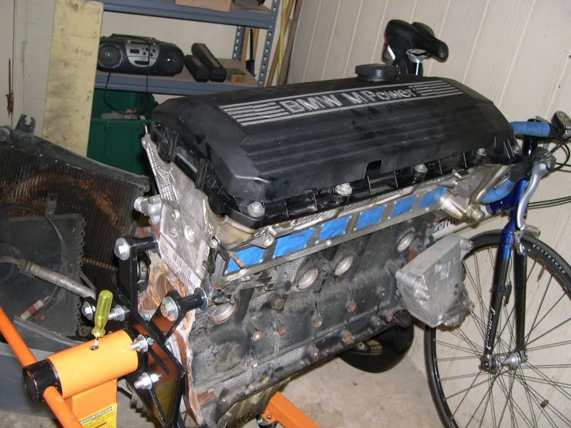

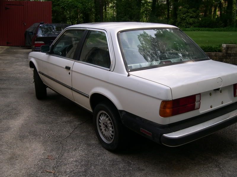

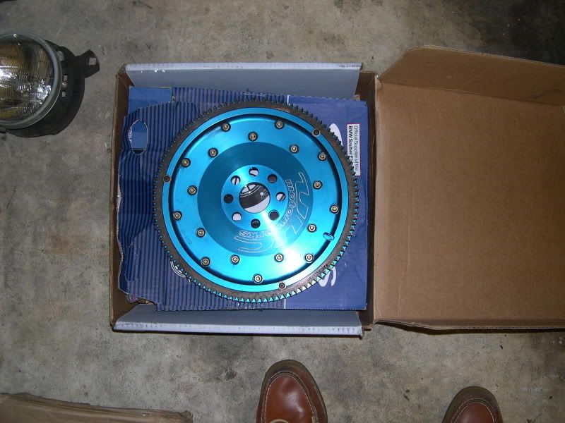

                        Picked the car up today and snapped some pictures before it got dark. Here's a quick sample of what I have. At the moment my garage is packed with parts for the car/motor. I'll get some more as I go.
                        • lifeiskaos
                          • 1709
                          cute seats
