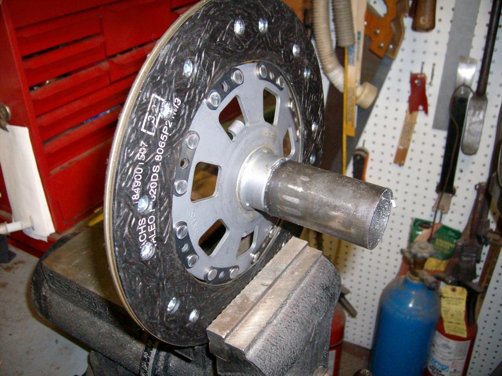

    I have just gotten to this page. I'll read up and edit my post but at this time The F1 chromoly flywheel will not work with the stock Sachs S52 clutch disc and pressure plate. You'll need to cut 3mm to 4mm off the nose of the ZF 320 throw out bearing guide tube. otherwise the guide tube will override roughly 3.5mm of the hub of the clutch disc and will weld itself to the disc. This will lock the engine up. You'll have hell to pay getting the box separated from the engine. This was my experience.
    I had read that this was a common combo to use and did not see anyone else encountering this problem.
