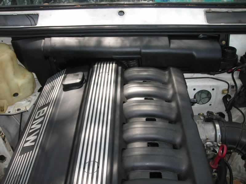

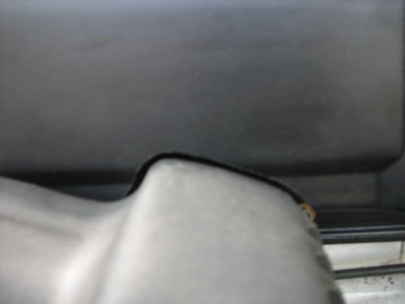

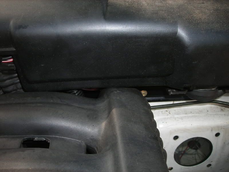

        So today I finished my wiring and started my m52 for the first time. The wiring fits fine:
        BUT, the cover interferes with the intake manifold (no picture yet)
        I've heard that the fuel rail cover needs to be trimmed, but does the main cover need to be trimmed to clear the intake manifold?

          looking godd, very neat... isnt the x20 plug supposed to go outside the cover on the rhs where there is a hole for it?

            I replaced the x20 with a c101. I deleted my diagnostic connector since I will soon be running standalone EMS, but it's usually supposed to go on the outside, closest to the fusebox.

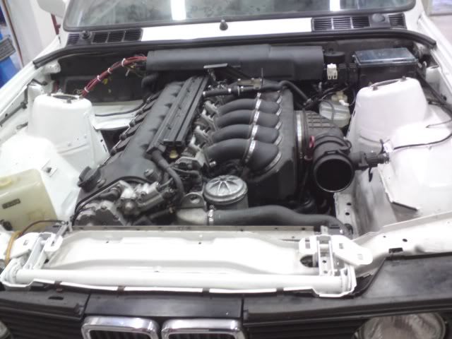

                Originally posted by Mohammed_A
                Dont know if your guys OBD1 has the same amount of wires as the s50 Euro which has a seperate computer box for the Vanos, i had lots of wires......
                what i did was shortened them alot and resoldered every one that was cut.
                The cover fits but just.... would like to make the bunch tighter.... anyone have the cover which goes by the battery tray that joins the harness cover? its not available in South Africa..

                  I didn't trim any wires for my RHD Euro S50. Only cut and soldered some wires that crossed in bad spots. Everything barely fits in the cover but the relays had to go outside next to the fuse box.
                  Here's how it looked. I know it's a mess but it's not too bad after the cover is on. In this picture the diagnostic plug was still not in its holder. It's hard to see but I also put some black plastic looms over some wires outside of the cover.
                  After the cover is fitted.
                  The wires over the battery tray will be covered with the M3 cover.

                              mine fits fine too, and i even rerouted the diagnostic plug back so that it was in the spot beside the fusebox... eliminated the x20, and thanks to my early model square C101 that mounts on the driver side of the fuse box, i had lots o room inside the cover.
                              I had to add a few more pins to the square C101 to make everything work.
