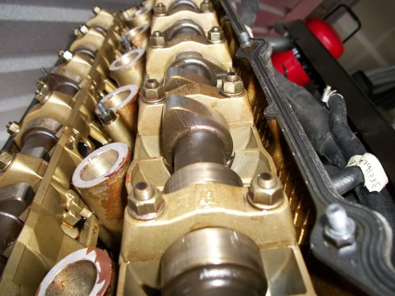

Can you please take some pics/measurements of your cams?
I picked up a set of what were supposed to be s50 cams from another member of the forum, and I just want to triple check that what I actually received was one s50 exhaust cam and one m50 intake cam. The seller is being good about it, he is refunding me, I just want to make sure.
My measurements are as follows:
Both cams have lobe base circles of 38mm
The cam marked A (exhaust) has a total lobe diameter of 47.7mm
The cam marked E (intake) has a total diameter of 47mm
So...
Exhaust = 9.7mm
Intake = 9mm
From what I understand: s50 should be 9.7mm exhaust, 10.2mm intake. m50 should be 9mm exhaust, 9mm intake.
Here is a pic of the exhaust (left) and intake (right).
You can see the more rounded tip of the cam on the left, and the sharper tip on the right.
Here is a pic from another website comparing an m52 228 duration cam with an s52 240 duration cam:
From what I understand, my intake cam should be slightly more rounded then the exhaust cam, as it should be 252 intake and 240 exhaust. Instead, it's much sharper, as if it was a 228 duration.
Are my findings correct?
