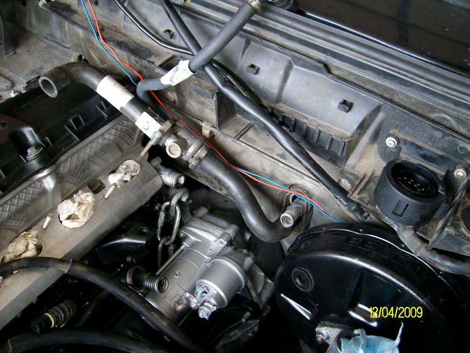

      Kind of hard to see, but there it is...
      • 7pilot
        • 475
        Here you can see my lift links hooked up to the rear lift point . It is about 11 o clock relative to the starter mounting flange.
