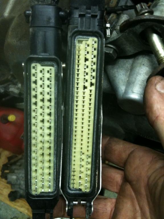

 pic 1 shows 2 plugs on engine harness(with the car side plugged in from donor car)

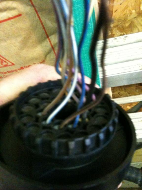

 pic 2 is what I believe to be the engine c101

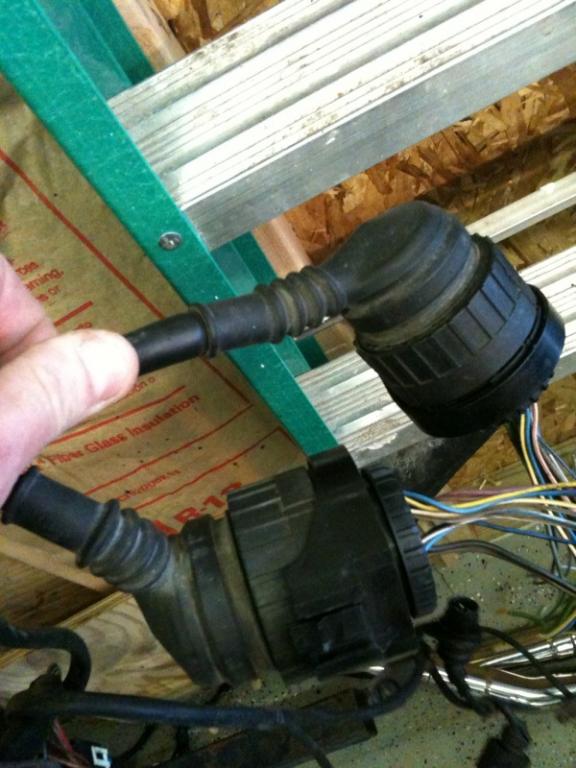

 pic 3 I believe went to the auto trans in donor car

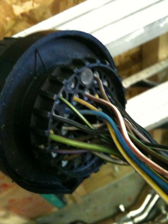

 pic 4 are the plugs on the engine harness that go through the firewall into the glove box.
 I am assuming I can delete the harness plug in pic 3, and the smaller gb plug in pic 4 and all its wiring in between???

 Correct, open the DME plug and trim the unused wires right back to the connectors, you will also be removing the autobox wiring plug which is down by the O2 sensor plug.
