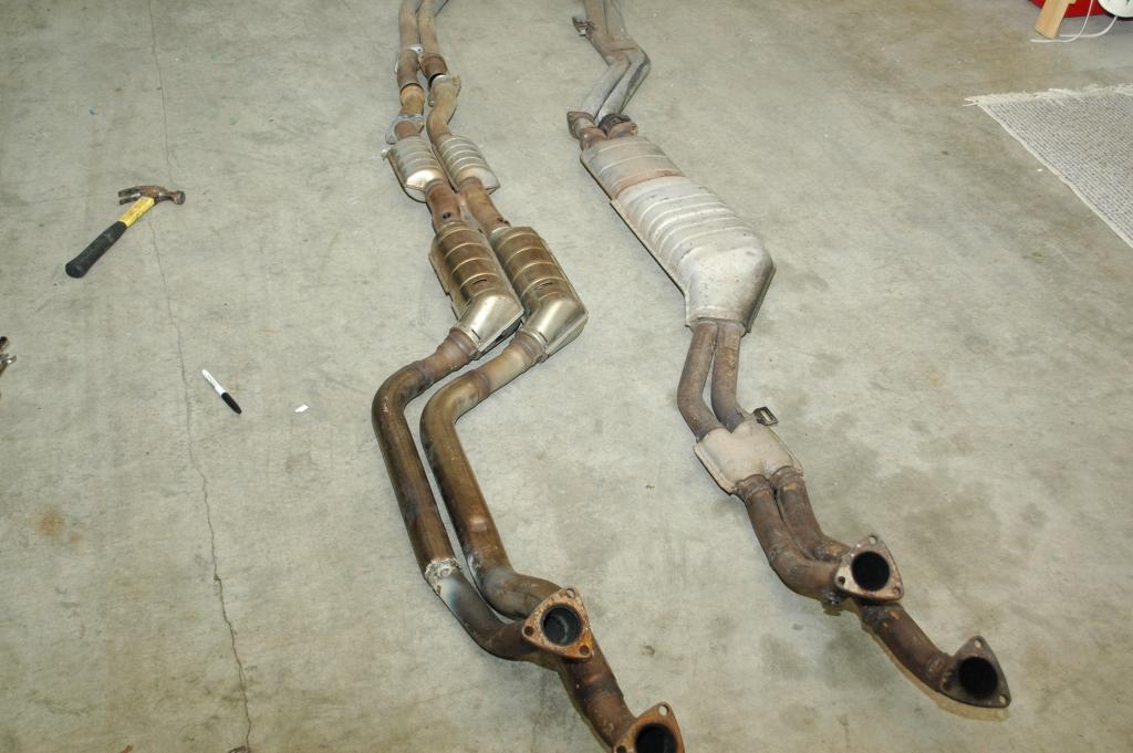

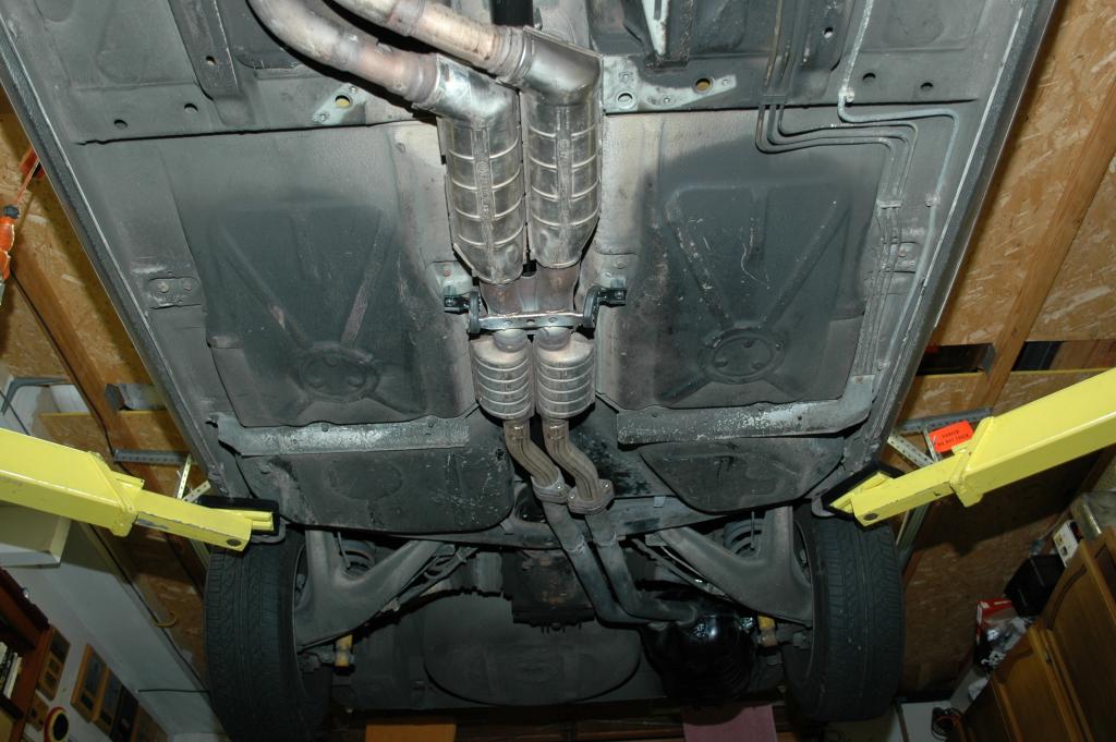

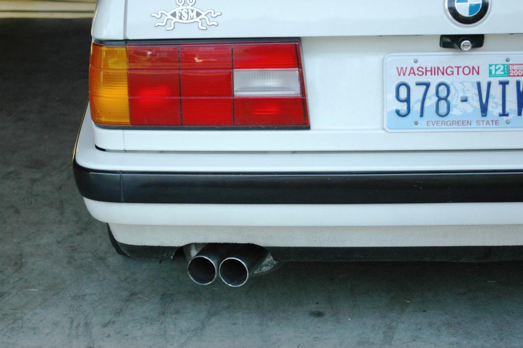

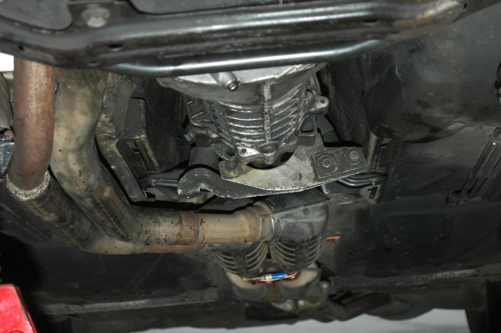

                    Originally posted by sharky
                    hoveringuy do you have any pics of the stock M3 catback on your car? I really love my Tubi but kinda want something quiet.
                    OBD2 exhaust (left) e30 exhaust (right) e30 exhaust has M50 downpipes grafted to it. The OBD2 cat section only needed a few adjustments to fit. The biggest trick was the passenger side downpipe is rotated so that it was closer to the other pipe which let it clear everything nicely. The fat part downstream from the weld is double-wall.
                    fitment at swaybar
                    tips need to be cut and welded at a different angle to fit e30 rear valence. Flying Spaghetti Monster!

                          Thanks for information everyone.
                          After starting to chop the obd2 stock exhaust and reading a bit more, I decided I "cooould" do this.. but not right.. and not the way it should be done. So I'm forking over the money to get it done right.
                          And on that note... I'm going to pay to do this right one time and one time only. (sorta). I'm thinking of 2.25'' or 2.5'' pipe from the downpipes, then right after they clear the control arm / sway bar mess -> X pipe or H pipe (which is better?) -> to stock obd2 resonator/cats -> stock obd2 muffler for now (depending on how much they qute me), trying to maintain the larger pipe size where I can.
                          If things arn't too pricey I'll do a different muffler. (fingers crossed)
                          I don't want the end result to be TOO loud, but some volume and def tone is the goal. This WILL be my daily driver. I had a 95 e36 M3 with Borla muffler on it and it sounded awesome.
                          Oh yeah, so since I converted everything to obd1 I only need 1 o2 sensor? Where are you guys putting it? In the stock obd2 position? then just pluging/welding the other hole? The position of the obd2 o2 sensor as other people have mentioned before sucks, has anyone had luck moving it? If so to where?
